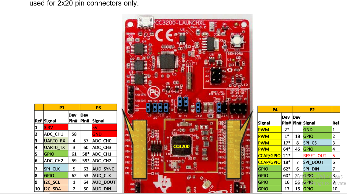

I want to connect external device to cc3200 via UART. So I was checking it through , connecting a USB to UART board to CC3200 and by typing on hyper terminal like Putty and getting the characters in UART interrupt handler. But there is no document which would explain how to configure UARTA1 and how the external emulator board (USB to UART) is connected to cc3200 and at that time how should be the jumper setting.
Can guide me on above three point? I would appreciate if anyone help me on this.

    Alternatively, if you are fine with not having UART0 connected to your computer, is to simply move the J6/7 jumpers from 'FLASH' to 'BP'. This routes the UART0 signals to the launchpad headers instead of the onboard USB->UART chip. The UART0 signals will then be available at pins 55 and 57.

    4)  I've connected USB to UART chip's TX to pin-55 and RX to pin-57 and jumper J6 and J7 are on BP mode, In my case,COM ports for CC3200LP is COM10 and USB serial port is COM3. SO I open Putty terminal with COM3, But then I get a message: Error Connecting to target in CCS. It seems like, it can't route the UARTA0 signals to Launchpad headers.
    5) But when I open Putty with Virtual COM10 with jumper on FLASH mode it works fine ( Works on only UARTA0)
    6) In hardware guide of cc3200 they clearly metioned that on  pin-3 and pin-4 you can get UARTA0 signal( this is something bit confusing as you also get UARTA0 signal on pin-55 and pin-57) but what should be the jumper setting in each case?
    7) Could you please explain, how to connect external USB to UART board / or external device to CC3200 to see output on PUTTY(which should be the COM Port while opening the hyper terminal, whether it should be Launchpad's or USB Serial's COM?

    The UART0 signals are assigned in the pinmux.c file like the other peripherals on the CC3200. You can check in your local pinmux.c to see what are the pin assignments for UART0, but for all of the SDK examples the UART0 signals are muxed out to pin 55/57.
    Once you have moved the UART jumpers (J6/J7) to BP, you should no longer use the CC3200's COM port in your terminal emulator. You should only be using your USB serial COM port. Your USB->UART device should be connected to the launchpad header pins where you muxed out the UART0 signals.
    Michael
  • Hi Michael,
    Thanks a lot for your reply!
    It is now working perfectly. I am able to get UARTA0 signals on Launchpad's pin-55 and pin-57.
