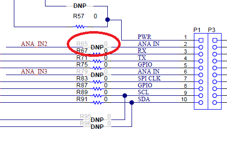

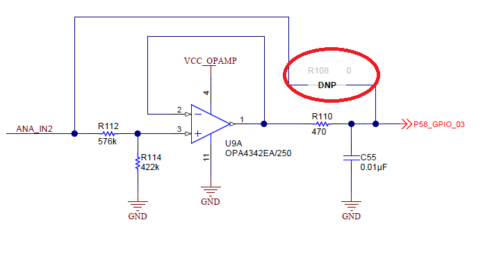

  • David,
    I see why you might have been having trouble with the expressions/registers tab because there are no CCS peripheral register definitions for the CC3220 yet.
    Additionally, I suggest that you choose to experiment with a GPIO other than GPIO 3. The reason why I say this is because GPIO 3 is not routed to Pin 2 of Header, P1, as the 0 ohm resistors connecting the path are depopulated by default (image from schematic shown below).
    This was intentionally done so that GPIO3 could be used as an ADC input by default, routing it to pin 5 of header, P3 through the OpAmp.
