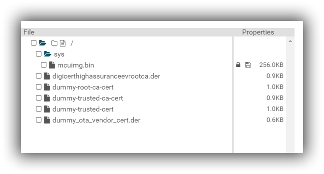

I'm having trouble determining why the cloud-ota example fails for me.
I have downloaded the der file for digicerthighassuranceevrootca.cer from the digi_cert site and renamed it to .der
I have flashed the Launchpad with the certificate structure:
I already had a dropbox app set up, I used the Folder Name from before "VizcoUpdates" and I regenerated the access token and used that.

However, when I debug the application, It fails at the point where it tries to list the folder contents.
What might I have missed??

  • Hi Chuck,
    You've succeeded connecting to Dropbox, but failed on the first HTTP request (requesting the content of the OTA directory).
    From some reason Dropbox responded with HTTP 409 (Conflict) Error for the request.
    This is probably related to the definition of OTA_VENDOR_DIR that is not aligned with what you defined in your Dropbox APP (note that in the Dropbox app you define, the OTA tar file should appear within a directory with the name defined by OTA_VENDOR_DIR).
