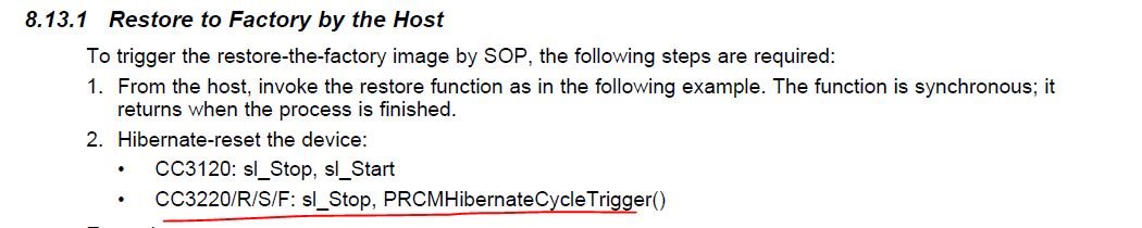

I'm trying to figure out what the exact procedure is to execute a host driven factory reset on the CC3220.
The simplelink programmer's guide () is not very clear on this.
As far as I can tell, with SOP[2:0] fixed on 000, I should just run the following code:
_i32 slRetVal;
SlFsRetToFactoryCommand_t RetToFactoryCommand;
_i32 Status, ExtendedStatus;
RetToFactoryCommand.Operation = SL_FS_FACTORY_RET_TO_IMAGE;
Status = sl_FsCtl( (SlFsCtl_e)SL_FS_CTL_RESTORE, 0, NULL , (_u8 *)&RetToFactoryCommand ,
sizeof(SlFsRetToFactoryCommand_t), NULL, 0 , NULL );
if ((_i32)Status < 0)
/*error*/
//Status is composed from Signed error number & extended status
Status = (_i16)Status>> 16;
ExtendedStatus = (_u16)slRetVal& 0xFFFF;
break;
//Reset
sl_Stop(10);
//sl_Start(NULL, NULL, NULL);
//CC3220
 PRCMHibernateCycleTrigger();
But is this all? Is this supposed to fully execute the entire factory reset?
From what I can see, this seem to do -something-, but after a while seems to reset the device which then fully hangs. (nothing happens/boots. Nor the old or current image)
Even when unpowering/repowering and waiting a long time, nothing seems to happen.
Only when I toggle the RESET line, after 10+s the system seems to reboot into a valid image again.
Is this behavior to be expected? And/or what is the full procedure to execute a host-driven factory reset? Am I missing something, since the toggling of the reset was not outlined in the datasheet?
Thanks for any clarification.
Arnout

    I have two additional questions:
    - In your code snippet, you do "factory reset" + sl_stop + sl_start + reset. The datasheet seems to tell to not do the sl_start before the reset. Is this then wrong in the datasheet?
    - The datasheet also uses PRCMHibernateCycleTrigger, while you use PRCMMCUReset. Is this of any significance?
    Thanks for your reply!
    Arnout
    I got it working now that I disabled the HW wdog.
    It clearly fired during the operation, causing everthing to get screwed up pretty bad.
    (Also, the PRCMHibernateCycleTrigger/ PRCMMCUReset does not seem to matter).
    Thanks for the help.
    Kind regards,
    Arnout
