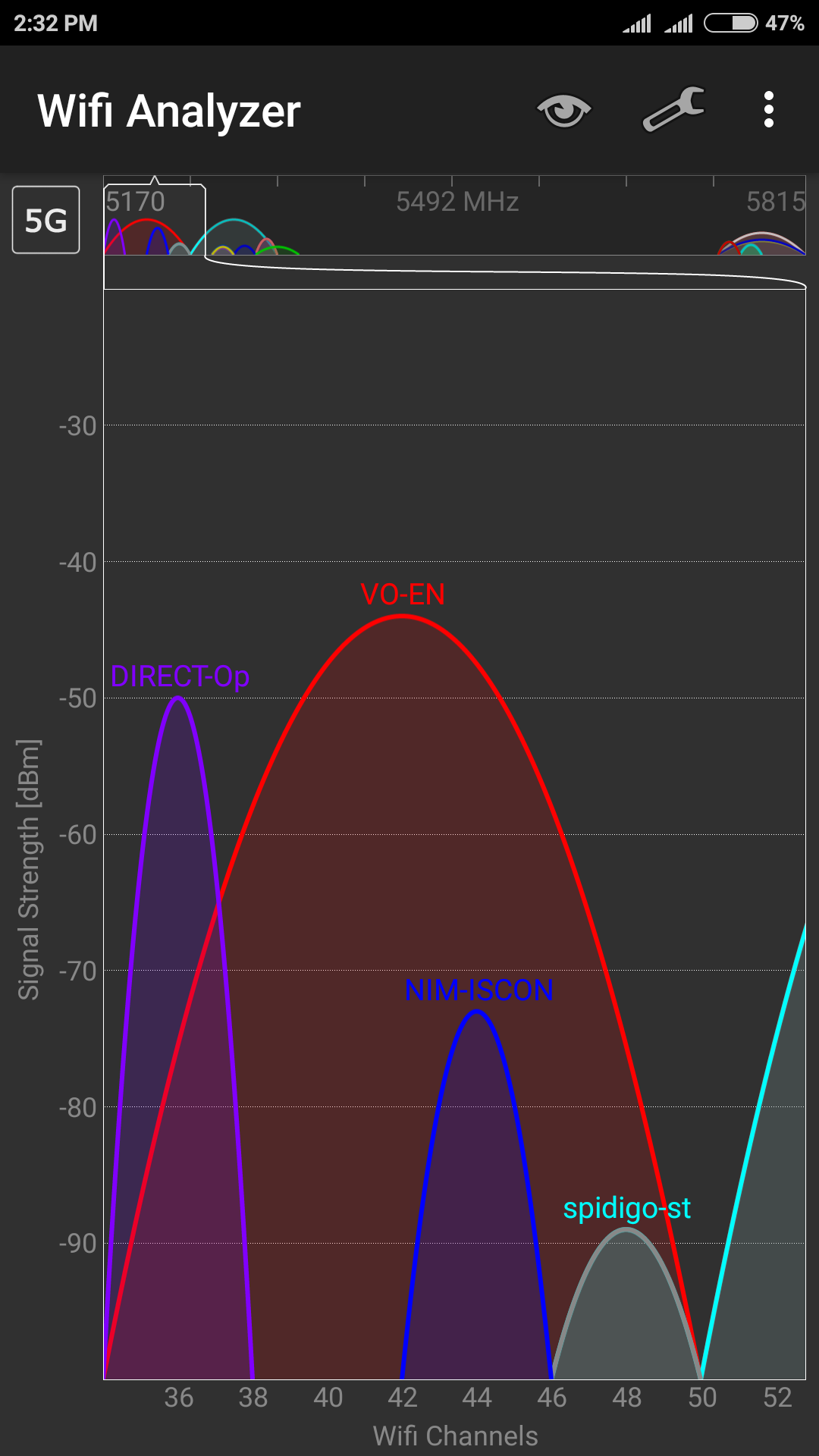

I am using WL1837MOD WiFi module with NXP's iMX6D processor (Android KitKat 4.4.3) for my ongoing project. we have created p2p go at 5180 freq(n mode) in one device and another device act as a client. Now I am trying to measure network latency using Ping command in between both devices. In to the ping command logs I have observed that average latency is 2-3 ms. I have observed one more strange behavior, after every 10-15 sec latency increase to ~900ms. can you tell me the reason behind this?
Below are Ping command logs. I have highlighted high latency part.
