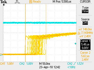

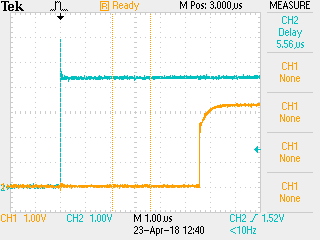

    1. Yes, the offset is observed even after the location fix has been achieved. I have attached two traces that show what we observe.
    In Fig. 1 the blue trace is the PPS signal from a reference timing receiver, and the orange trace is the PPS signal from the WL1871 module. As you can see, the WL1871 signal is shifted by about 5.5 us. We have captured the trace over many hours, and observed that the offset always remains and doesn't improve.
    Fig. 1
    Fig. 2 below is a close-up of the PPS signal edge - as expected, it jitters around, but the jitter itself is pretty small, of the order of +/-70 ns. So, it would seem that the module timing accuracy spec should be able to quoted as approx. +/-70 ns, but the systemic offset of 5.5 us makes it much worse. Since the offset is always there and is also pretty large, it almost seems like an artifact some software behavior in the module, rather than a function of the receiver capability. So that's why were wondering if there is any way to correct this.

  • HI Anand,
    Thanks for sending this data!! Does the offset vary based on the TCXO offset clock? Pl let us know if you have performed any such experiment. Also is the offset constant across different devices or vary from device to device.
    Sudharshan K N
