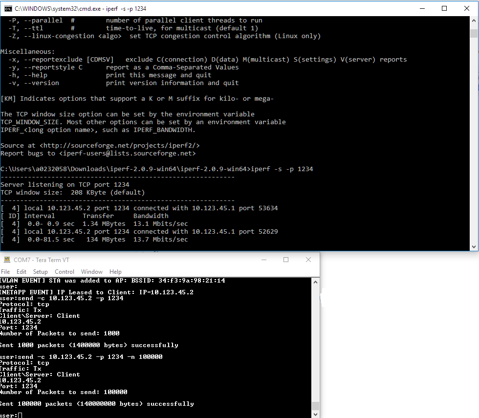

    I just retested the network terminal example and have gotten the results as expected in the datasheet:
    I advise you to check your test setup and environment to ensure that nothing is impacting the throughput test. In your terminal capture in your previous post, the client you are transmitting to has IP address xxx.xxx.xxx.4. Is there more than one device connected to your AP?
    Michael
  • Hi Michael,
    We were able to transfer from CC 3220 (client) to PC (server).
    When I set it again, IP changed from xxx.4 to xxx.2.
    Is not this reverse transfer possible?
    Also, UDP transfer does not work, how should I set options?
    Successful log
    CC3220 side
    user:send -c 10.123.45.2 -p 1234 -n 100000
    Protocol: tcp
    Traffic: Tx
    Client\Server: Client
    10.123.45.2
    Port: 1234
    Number of Packets to send: 100000
    Sent 100000 packets (140000000 bytes) successfully
    Protocol: tcp
    Traffic: Tx
    10.123.45.2
    Port: 1234
    Protocol: tcp
    Traffic: Tx
    10.123.45.2
    Port: 1234
    Sent 10000 packets (14000000 bytes) successfully
    user:
    PC side
    C:\Users\136867\Desktop\iperf-2.0.9-win64>iperf -s -p 1234
    Server listening on TCP port 1234
    TCP window size: 208 KByte (default)
    [ 4] local 10.123.45.2 port 1234 connected with 10.123.45.1 port 57805
    [ ID] Interval Transfer Bandwidth
    [ 4] 0.0-86.8 sec 134 MBytes 12.9 Mbits/sec
    [ 4] local 10.123.45.2 port 1234 connected with 10.123.45.1 port 50250
    [ 4] 0.0-85.5 sec 134 MBytes 13.1 Mbits/sec
    [ 4] local 10.123.45.2 port 1234 connected with 10.123.45.1 port 64491
    [ 4] 0.0- 8.5 sec 13.4 MBytes 13.1 Mbits/sec

  • Hi Da,
    I see that you are getting the expected TCP throughput numbers now.
    TCP RX can be tested with the same network terminal.
    On the CC3220 side, you would run the following network terminal command:
    recv -s -p <port> -n <number of packets>
    On the PC side, using iperf you would run:
    iperf -c <cc3220 IP> -p <port> -n <number of bytes>
