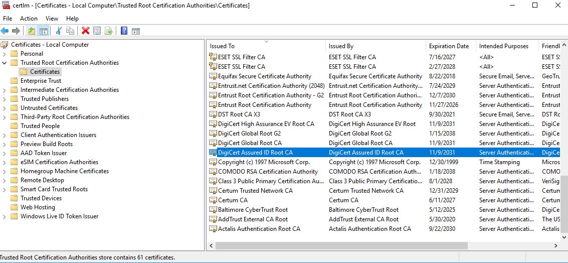

Thanks for the response - I gave that a try and found what I "thought" was the certificate (see attached graphic)
But, when I exported it, it gave me the option to name it so I gave it the same name of "digcert_high_assurance_ca" and it
exported as "digcert_high_assurance_ca.cer" with a different extension (if gave me ".cer", not ".der")
I added this new file to my uniflash build (in the user files section) and created an SLI for download - when I burned it to the device, the device did not run after the download or run after a power cycle.
So, I don't think that apporoach is going to work.
The "Over_The_Air_Update_Guide.html" instructions explicity said to download this particular "digcert_high_assurance_ca.der" certificate from githb or dropbox - like I said, when I go to their sites and even google it, I get NO RESULTS.
Does anybody know how to get "digcert_high_assurance_ca.der" from github or dropbox? Or, can someone email me a copy of that file?
