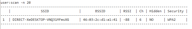

    When I use the scan -n 20 command to search for WIFI, I can only search for WIFI below.
    But other WIFI SSIDs are not searchable.

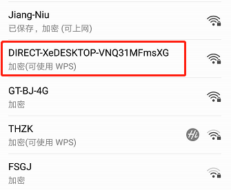

    The picture below is the WIFI I searched by mobile phone.
    Do you know what causes other WIFI SSIDs not to be searched ?
    Thank you.
    Andre

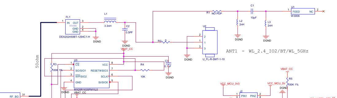

    The RF design circuit diagram is as follows:
    Do you have any suggestions?
    Andre
  • Hi Andre,
    Sorry, I am not able to help you with these RF design aspects. Please wait to answer from TI engineer. But I think you should share your RF layout as well.
    I am not expert at this points, but I think there are two important aspects for proper wireless performance:
    Jan

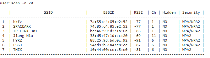

  • Hi Ben M,
    Running the network terminal on the EVM can be performed as expected.
    The EVM display is shown below:

  • Hi Ben M,
    Our custom WIFI board can only find signals that can use WPS.
    What causes it to only search for WPS ?
    Whether it is related to this configuration ?
    Andre

    Customized CC3120 WIFI board, sometimes can find the following signals, sometimes not found. The information is as follows:
    The signals that can be found using the CC3120-BOOST EVM are as follows:
    RF circuit diagram in the above link.
    Customized boards can only search for one signal or no search for signals. What are the reasons ?
