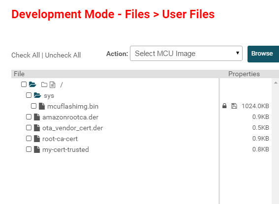

We then placed root-ca-cert certificate inside ExampleknownCA folder (to insert it into catalog - the only one that we need)

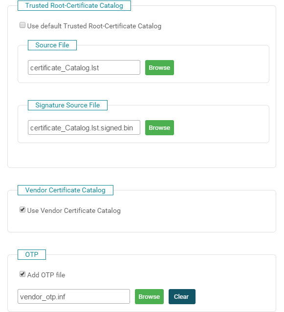

Then we created the custom catalog and the OTP (windows powershell prompt):

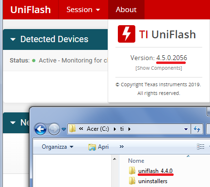

cd "C:\ti\uniflash_4.4.0\simplelink\imagecreator\bin"
.\SLImageCreator.exe tools make_cert_catalog --cert_folder "C:\Certs\ExampleknownCA" --out_file "C:\Certs\certificate_Catalog.lst"
.\SLImageCreator.exe tools sign --file "C:\Certs\certificate_Catalog.lst" --priv "C:\Certs\root-ca-key.pem" --out_file "C:\Certs\certificate_Catalog.lst.signed.bin" --fmt "BINARY_SHA1"
# # creating OTP file
.\SLImageCreator.exe tools meta --cert "C:\Certs\root-ca-cert.pem" --out_file "C:\Certs\vendor_otp.meta"
.\SLImageCreator.exe tools sign --file "C:\Certs\vendor_otp.meta" --priv "C:\Certs\root-ca-key.pem" --out_file "C:\Certs\vendor_otp.meta.sig" --fmt "BINARY_SHA2"
.\SLImageCreator.exe tools inf --algo 2 --sign1 "C:\Certs\vendor_otp.meta.sig" --sign2 "C:\Certs\vendor_otp.meta.sig" --meta "C:\Certs\vendor_otp.meta" --out_file "C:\Certs\vendor_otp.inf"

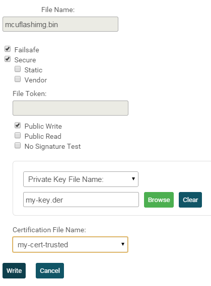

In some way, the MCU can't validate our binary image. What are we doing wrong?
