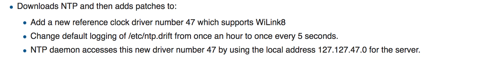

Dear Ti Community,
I am now working with AM335x and WL1835MOD. My application need to synchronize all STAs in a infrastructure network (sync by TSF in beacon of Access Point).
I have find out that TI has a thread for WL18xx Clock Synchronisation with NTP:
processors.wiki.ti.com/.../WL18xx_Clock_Synchronisation_with_NTP
processors.wiki.ti.com/.../WL18xx_Clock_Synchronisation_with_NTP_in_SDK3
I understood that for synchronize 2 H/W AM335x & WL1835MOD. I need to create some modification as applying some patches to modify Wilink Driver R8.7 and NTP
But currently, the link for package patches of Wilink Driver R8.7 and NTP has been disabled. Could you please help to tell me, where can i find out these patches?
or How can i continue to do my application without patches?
Thank you very much!

  • Hi Mr. Saurabh,
    Thank you very much for your kindly support!
    I understood that your reference is solved problem with synchronization time by TSF counter.
    For my both references link, one more thing i really want to know is related to NTP patches (attached image):
    Could you please help to give me some information about these NTP patches?
    The server where these patches were uploaded seems to have been decommissioned .
    I am not able to find backup of these patches . I will keep checking and if I find patches I will let you know.
    Saurabh
