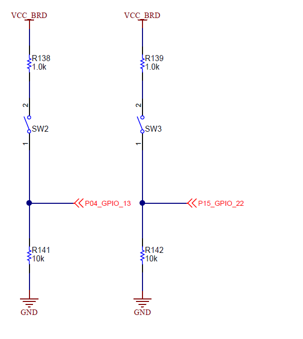

Hi I am trying to Use UART0 with GPIO12 and GPIO13 for TX and RX respectively.
But, no data is receiving in PIN04  or GPIO13. I wondered that same data is receiving in GPIO2 where I assigned GPIO13,  similarly GPIO1 & GPIO12 both are individually working for TX where I assigned GPIO12 for TX.
Can I know the magic behind this? and how to use GPIO13 as RX in UART0.

  • We were lucky enough to find this thread. We are having the exact same issue on the 3220S LaunchXL. We are also trying to move UART0 from pins 55 and 57 to pins 3 and 4. And, we are seeing pin 3 data output. We are also not using DMA.
    We are able to see transmissions from uart tx (pin 3) using our logic analyzer, but the uart rx (pin 4) does not receive the data when they are jumpered together.

  • Hi Christopher,
    Working fine with all other UART supported pins except UARTCC32XX_PIN_04_UART0_RX. I tried with external Pull-down and/or Pull-up also, no progress.
  • Chris,
    The issue here is that the RX pin (Pin04) is being pulled down elsewhere on the launchpad. You will need to remove R141 to get RX working correctly.
    Vince
  • Hey Vince,
    We tried removing the resistor but the uart still will not read any data. If we look at our logic analyzer, the data appears to show on pin 4 without any problems, but UART_read still never reads any data. We tried Pins 7 and 8 on UART1 again and it still works just fine, but due to our project constraints, we can only use pins 3 and 4.
    Is there additional configuration that is needed? We tried using the PinMux tool to recreate our configuration, but still no luck.
    Chris
  • Hey Chris,
    Found the issue.
    Root Cause -
    Pin 55 and Pin 57 get configured by default on boot to UART0 TX and RX, respectively. inside the PRCM init() function, we should be taking care of this by determining if these pins are configured in UART mode and unconfigure them. This does not occur correctly, and the pins are thus left muxed to our UART peripheral which causes issues if you want to use your other pins (4 & 5). I have reported this bug to our R&D and should get updated in future SDK releases.
