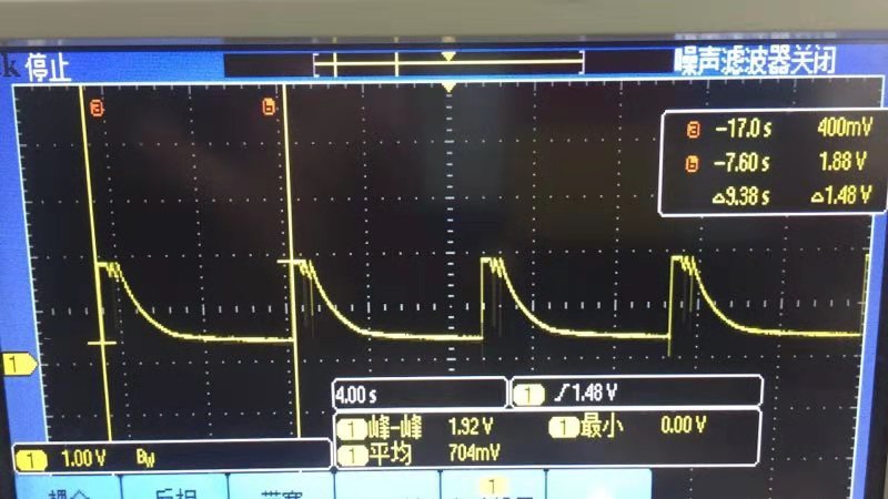

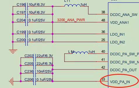

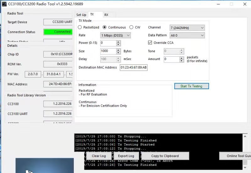

Hi Team
        Our Ctm  are having issues with the continuous mode Tx mode in Radio Tool. When the CC3200 is asked to start transmitting, it will transmit but only for a few seconds(~5seconds) before it stops completely.
        Ps. 1. The version of Radio Tool is lastest
              2. The most of continue time is less than 5s but it will also spend about 1 minute sometimes
              3. The problem seems still exist even though we set the output of power to the maximum
              4. The problem seems still exist even though we select the option of override CCA
              5. Ctm's product can communicate normally in their production test and there is no off-line problem in their production test
