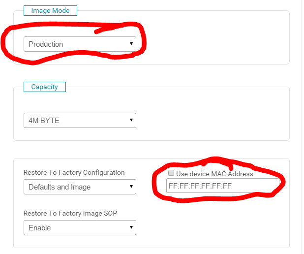

  • Hi Michael,
    Our engineers here were able to capture the python script's programming protocol. We mimicked this protocol and were able to get all the way through step 11 with the wifi chip sending the expected responses. After the very last chunk, the chip is suppose to send "0 cc 0 0 0 0" however we still get " 0 cc d7 dd 10 74" just on the last chunk. We have verified the data in this last chunk. (header and data matches what is sent by the python script). See our output below:

    INFO: WIFI_PROG_RAW_RCV: [cmd:34] Rsp[6]: 0 cc d7 dd 10 74    <- should be zeros
    We suspect a timing issue at this point and any information on what this code means would be extremely helpful.
    Thanks, Glenn.
    PS: An error code of 0x41 means a bad checksum.
  • Hi Glenn,
    The return code you get of 0xd7dd1074 from command 0x34 seems to be some form of file integrity error.
    If you get an error from cmd 0x34, the first 16 bytes after the 0xcc ACK is a filesystem error number that can be referenced against source/ti/drivers/net/wifi/errors.h in the CC3220 SDK. In your case, you have 0xd7dd == -10275 or FS_PROGRAMMING_ILLEGAL_FILE.
    The second 16 bytes refers to the line number in the bootloader code at which the error was thrown. For you, that would be line 0x1074 or 4212. Unfortunately, the bootloader code for the CC3220 is not public but I looked at the source for you to identify what that line corresponds to.
    At line 4212, the bootloader is checking the SHA1 hash of the file you just wrote, and comparing it against the expected SHA1 hash of the file from the file table of the .ucf file you are programming to the device. If it doesn't match, then it throws a FS_PROGRAMMING_ILLEGAL_FILE error. That means that for the file you are programming in step11, you most likely had some corrupt data passed on the UART interface during the file flashing sequence. The other potential cause would be if the file table in the .ucf file somehow had the wrong SHA1 hash for the file, but that can be tested for by running the .ucf you are programming through the embedded programming python tool released by TI and seeing if it works without an issue.
    Please double-check your UART programming flow and ensure that the data passed to the CC3220 bootloader is not corrupt. Let me know if you have more questions on the internal operation of the bootloader.

  • Hi Michael,
    We corrected our timing issue and the WiFi chip no longer responds with illegal file error code. Also, we have verified all 47 chunk checksums against those generated by the python script. At the end of programming, the wifi chip generates the code:  "0 cc d7 fa b fc".
    d7fa is (-10,246) which in the errors.h file is SL_ERROR_FS_DEVELOPMENT_BOARD_WRONG_MAC
    Would you be able to shed some light on what the code is checking in this error code case?
    Also, just an FYI, check status at the end reports 4a rather than 40.
    Thanks, Glenn
  • Hi Glenn,
    Is the Uniflash project that your .ucf is coming from configured as a development mode project? For projects configured in development mode, many debug features such as JTAG access are unlocked and as a safeguard against such images being programmed into devices in a production environment there is the requirement that the .ucf contain the MAC address of the target CC3220 being programmed. If the MAC address doesn't match or is missing, then the SL_ERROR_FS_DEVELOPMENT_BOARD_WRONG_MAC error is thrown. The MAC address can be provided manually through the Advanced-> General -> Settings -> Original MAC address field in the Uniflash GUI if you want to retain development mode capabilities in your .ucf, but that step will need to be done for every device you are programming. For production line purposes, your Uniflash project should be set to production mode.
    I suggest you double-check your Uniflash project to ensure that you are in production mode and not development mode, and then see if you are able to flash that new .ucf correctly.
    Michael
  • Hi Michael,
    After recreating the .ucf file using production mode, our programming function is now operational!  Thank you again! We couldn't have done it without all your help!
    One last question regarding the generation of the .ucf file. To get past the MAC_ERROR, we needed to be in production mode as you mentioned, but we also needed to specify a MAC of all FF's. Otherwise the python script (or our code) would only work on the device used to create the .ucf file. The problem with this is that it's changing all device MAC addresses to FF's. (See the uniflash settings below).  Would you know what the correct settings or procedure needs to be so that the .ucf file is independent of the MAC address?
    Glenn.
  • Hi Glenn,
    Good to hear that you have gotten the progrmaming process working with your code.
    For the Uniflash project settings, you should be able to just tick the "Use device MAC Address" checkbox and let the CC3220 use its unique device MAC address. With TI's embedded programming python scripts, I am able to take a .ucf configured in Production mode with "Use device MAC Address" set and program multiple different CC3220SF devices without issue.
    I suggest you double-check that the ..ucf you are using to ensure that it is indeed in production mode. I would also try your .ucf with the TI-provided python scripts, to see if the problem lies with the .ucf or with your code.
    Michael
  • We found the recipe.
    Thanks again!
