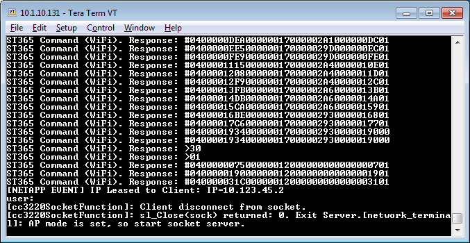

We have a product (ST365) designed around the CC3220MODA and the our firmware around the network terminal project.
Our product is set up as AP with a MAC computer connecting as the station and the MAC is running software that controls our product.  We had a case where after approximately 11 hours of connectivity the application running on the MAC stopped receiving socket data and after a few retry attempts gave up.  I see in the debug UART output of the CC3220 AP, that just before the end of the traffic that an IP address got leased.  The desk top software does not attempt to reopen a socket it only tries reading from the old socket.
I was wondering if it was actually a 12 hour DHCP lease setting on the AP that caused this but have not been able to find where the lease time is set in the example project. A search for "lease time" or for "leasetime" had no hits in the project. However I suspect the search does not go down into the library where there is a default for the lease time.
I would like help learning how to find how the lease time is set in the Network Terminal example project.  Is there a smarter way for me to search using CCS8?
I will attached the report I wrote up on our instrument connection failure too.Readme_ST365R1SN3.docx

    Unfortunatlly I cannot find a way to duplicate the problem. With the lease time set for 300 seconds and a MAC PC running our instrument control desk top firmware connected to 10.123.45.4 we left it run overnight (>12 hours) and the socket connection was still working this morning when I started work.
    I am wondering if some brief interuption of the RF path might trigger the event but I have dreamed up a way to do so. I tried wraping aluminum foil around our instrument which reduced the signal a lot but the MAC PC never lost connection. Neither the instrument, connected into my work bench development environment nor the MAC PC is very portable for experiments involving increasing RF path length.
    If it is not a loss of the RF link what else might have triggered the IP acquisition from the event I reported?

    Regarding, "Are you also monitoring the net app event handler for DHCP events?"  I did not know so I went into the SWRU455 section 5.7 and read a bit. That lead me to a project search for "slcb_NetAppEvtHdlr" with out success.
    Our code is based on the network_terminal example and there is the "SimpleLinkNetAppEventHandler" in the network_terminal.c file. So I think this is the event handlere of which you asked.
    I just added "UART_PRINT("\n\r[NETAPP EVENT] IPV4 IP Acquired");" to the only case that had no UART messages, the "SL_NETAPP_EVENT_IPV4_ACQUIRED" case.
    There is no case for SL_NETAPP_EVENT_IP_COLLISION in the code. I will try to add one that at least reports the collision out the UART PRINT. (Looks like SL_NETAPP_EVENT_IPV4_LOST,  SL_NETAPP_EVENT_DHCP_IPV4_ACQUIRE_TIMEOUT, and SL_NETAPP_EVENT_IPV6_LOST are all events which currently do not have a case in the code.)

    More information. We have again run another afternoon and night with the MAC PC controlling our instrument and no connection failures. And I have set the lease time to 5 minuets.
    Regarding, "You should implement reconnect algorithm into your PC app definitely."  I am reluctant to ask a co-worker to make changes with out a way to reproduce the original failure so that we could test such changes.
    The total clue we have is that the Net App event handler reported the lease of 10.123.45.2 and then control was lost and the Socket was closed..
    If not the lease time, what else might trigger the reassignment of IP address?

    I added more reporting to all of the cases of event types to the SimpleLinkNetAppEventHandler.
    We have run three or four instruments nearly 24/7 for some week or more and have never had any of the new events report in the log. We have never duplicated the one failure where the log showed that an IP address of 10.123.45.2 was leased even thought the station ( a Mac Mini) originally had 10.123.45.4.
    We have found a few instances where our device fails to respond to a request and our UART read routien which blocks causes the control software on the Mac Mini to give up the socket, but remain connected to the AP. The AP never changes IP address even after days. FYI, we set the lease time for 8 hours which was long enough we hope to be representative and short enough we would get results in a work day or two.
    Since my original question was about how to set the lease time and with your insights, I have changed the project to set the lease time and confirmed that a Windows 10 lap top and an Apple lap top and an apple Mini and an apple desk top Windows 7 all connected to the CC3220 access point and reported a lease time of 8 hours as intended.
    This resolves my problem of setting the lease time so I will mark this resolved.
