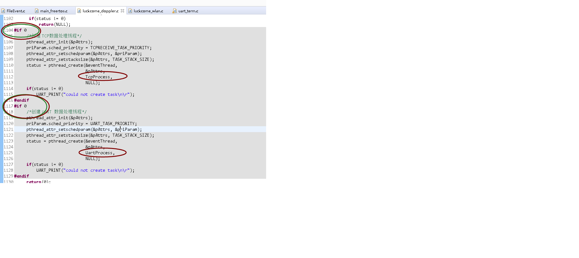

  • The board what i am using is LAUNCHXL-CC3235S (CC3235 launchpad) from TI.
    Currently I only have the only one CC3235 board.
    My code performs very frequent Wi-Fi scans because I have to keep getting the signal quality of wifi several seconds.
    I think I have to show you my software logic to you:

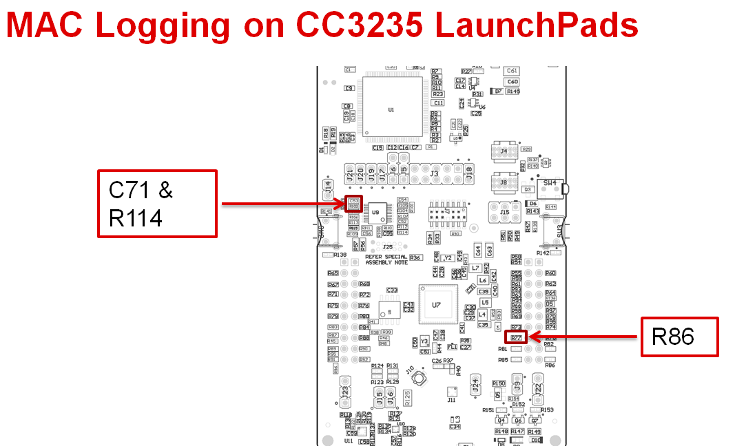

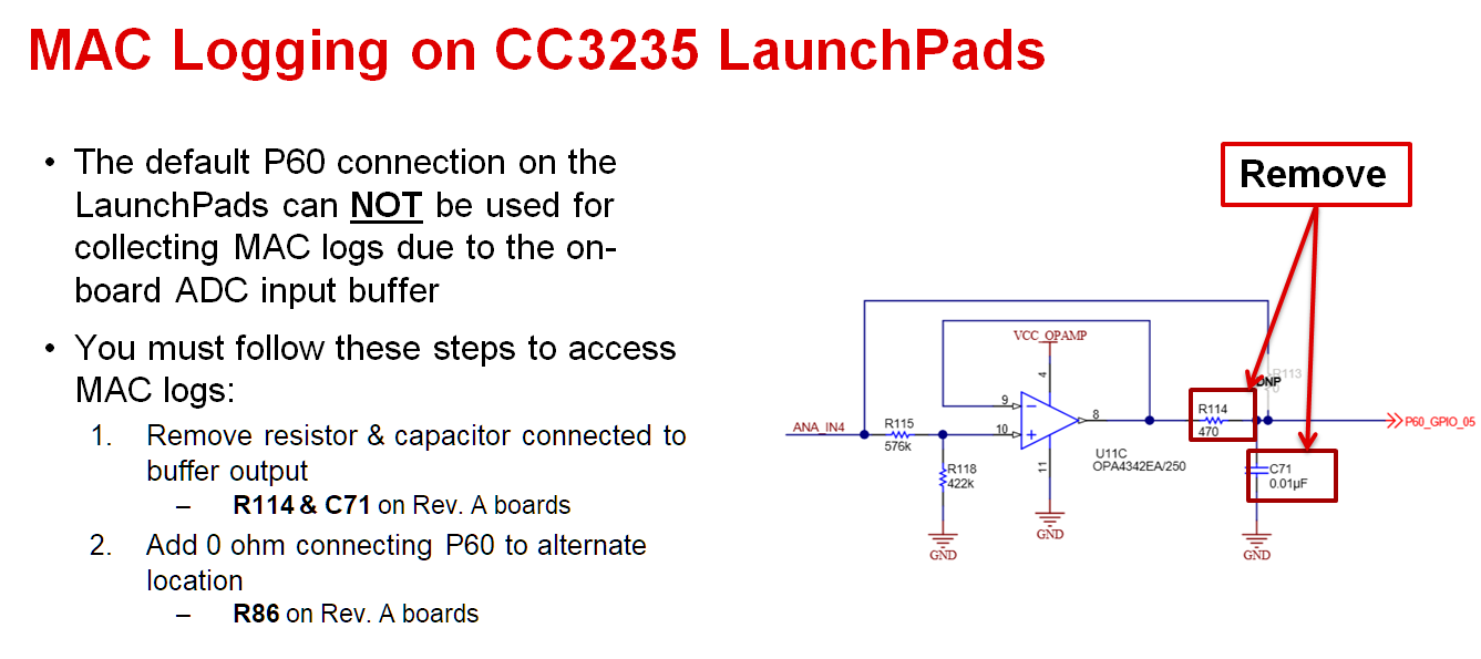

    Investigating the NWP logs provided a bit more, it seems like the cause of the stall -> abort is due to the low-level MAC HW encountering an error. To debug this further, MAC logs will be needed.
    In addition to the NWP logs output on pin 62, there are also low-level MAC logs output on pin60. To mux out the logs, you simply need to call MAP_PinTypeUART(PIN_60,PIN_MODE_1) right after the call to mux out the NWP log as per the instructions here http://processors.wiki.ti.com/index.php/CC3120_%26_CC3220_Capture_NWP_Logs.
    The UART setup is the same as for the NWP logs in terms of baudrate, stop bits, etc, so the logging setup you used for the NWP logs will work for the MAC logs. As with the NWP logs, the output recorded will be a binary that you will need to provide to me for decoding.
    As you are using the CC3235 launchpad, there are a few hardware mods that are needed for the MAC logs to be output correctly. By default pin60 is used as an ADC input pin, and so it has some filtering circuitry that needs to be disconnected.
    Please follow the instructions below to mod your board:
    Please collect the MAC logs and provide them to me so that I debug your issue further.

  • hi,Regards:
        Thank you very much for your analysis, I have already got the low-level MAC logs according to the steps you requested. Please gather the previous content to help me analyze it.
       thank you!
    edisonReceivedTofile-COM2-2019_10_17_9-19-50.DAT

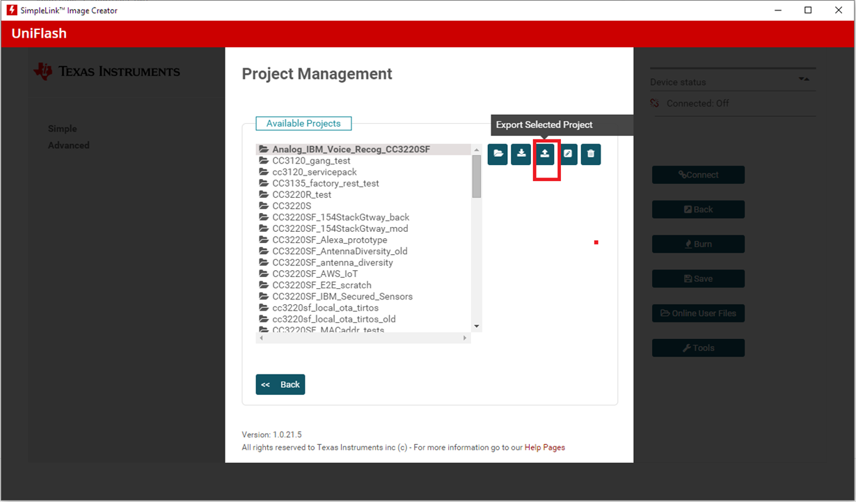

    I used to burn the program through the command line tool. The command line program is a .sli file generated by uniflash5.0, but I have never performed an erase operation,than i debug it. I don't know how to erase all programs. I have the following questions:
    1: How to burn the program in the production environment using uniflash, the official methods do not seem to work for cc3235s
    2: How has the chip in "product" mode been erased to erase the firmware inside?
    Uniflash should perform a full format of the serial flash every time you program the device.
    The CC3235S should be programmable with the methods outlined in the production line guide here: http://www.ti.com/lit/an/swra568/swra568.pdf
    It is not truly possible for the CC3235 to be in an empty state. While it is possible to not program an application binary to the device, and only allow it to run code loaded through JTAG, you will still need files on the serial flash such as the servicepack and root CA catalog for proper device operation.
    Michael

    At this point, the best way to ensure that I have the exact same setup as you is to run the same binary as you. While your AP name and IP addresses will be different from what I am using, I can adjust my setup to fit what your binary expects.
    Please send me the binary you are using through private message. It would also be helpful if you exported your Uniflash project to ensure that I have the same settings flashed as well. You can do so by clicking on Manage Projects at the home screen, selecting your project, and then clicking on export:
