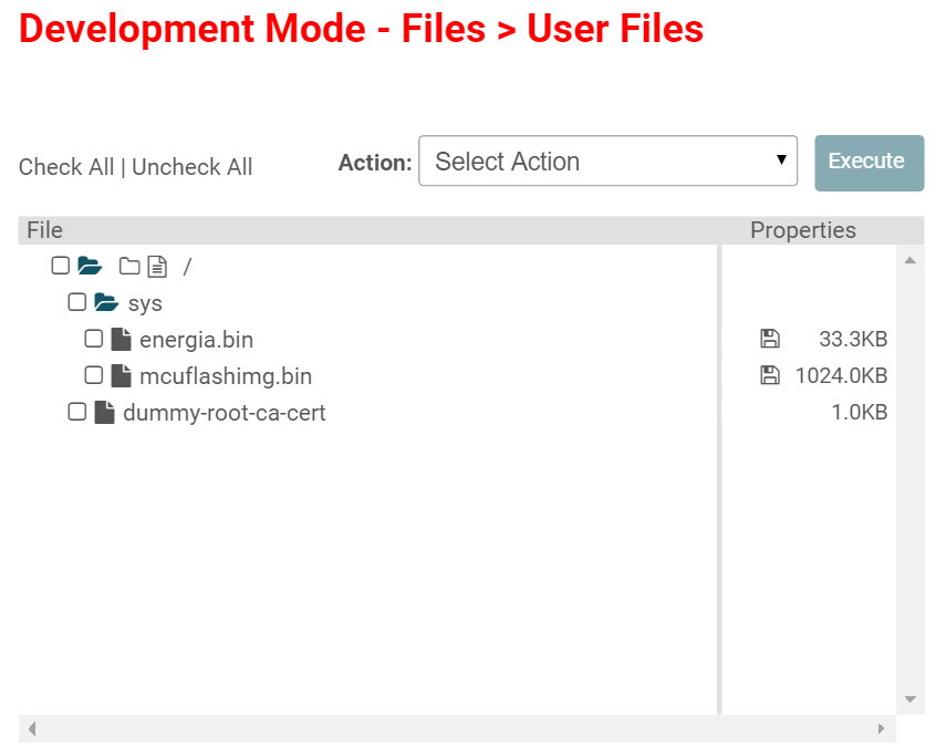

Hi
My application binary is generated in Energia, and I tried to load it using Uniflash. I learned from previous discussion that this was a known bug. Has this bug been fixed?
If not, it seems like I need to follow the steps described here. However, I ran in the this error message. "Operation failed: fs_programming error: ret: -10372, ex_err: 2633 - FS_WRONG_CERTIFICATE_FILE_NAME"
Just want to check if I misunderstood any steps. Thanks in advance in shedding some light!
My User Files Organization is shown below. By the way, is it necessary to burn the service pack before flashing application? My application doesn't use functions from the service pack. Previously, when I worked with CC3200, I used Uniflash to flash my application binary generated by Energia as /sys/mcuimg.bin, and I didn't need to burn the service pack.
1. Select "Select MCU Image" from the Action drop down menu and click on browse to choose boot-energia.bin in the zipped folder. Configuration is shown below
2. Click "Add File" next to "sys" folder and select my application binary generated in Energia (in this case, the Blink example) and name it energia.bin. Configuration is shown below

    How to use Uniflash in advanced mode you find at swru469. In brief:
    1. Create new Uniflash project for CC3220SF in development mode
    2. In Simple mode of Uniflash use GUI to upload my bootloader file into mcuflashimg.bin
    3. Switch into advanced mode. Upload your energia.bin into root directory (not into /sys/) as is stated at your screenshot
    4. Save, create and programimage
    (step 2. is important. In case you will use simple mode, your dummy-root-cert and key will be inserted automatically)

  • Hi Jan,
    Got it. Since my application was developed in Energia when I used CC3200, I think it would be faster to port it to CC3220SF if Energia environment is supported...
    Thanks for the summarizing the steps. I am able to successfully program the device. However, I am not able to run the application. I see the following error message. I put 'energia.bin' under the root directory, but it looks like the bootloader still has trouble locating the file...
    [NETAPP EVENT] IP Acquired: IP=10.123.45.1 , Gateway=10.123.45.1
    Unable to open file 'energia.bin' (code=-10365). Halt!

  • Hi Dennis,
    It looks that you have old version of my bootloader and from this reason you see [NETAPP EVENT] event. But this should not be a big deal and reason of your issue.
    That bootloader works by very simple way. It enables NWP by sl_Start() after that it reads content of 'energia.bin' file and copy it into RAM. After that it jumps to entry-point and stars execution of your code. In case you have already stored connection profiles NWP will start wifi connection when you call sl_Start() and from this reason you see this event. In newer version I removed this messages from asynchronous handlers.
    Now back to your error. You see error -10365 which means SL_ERROR_FS_INVALID_TOKEN_SECURITY_ALERT. I am not sure, why you see this error. Maybe you set file 'energia.bin' as secured file. That bootloder does not expect secured files.
    Jan
  • Hi Jan,
    Yeah, 'energia.bin' was set as a secured file. After unchecked the option, it worked fine.
