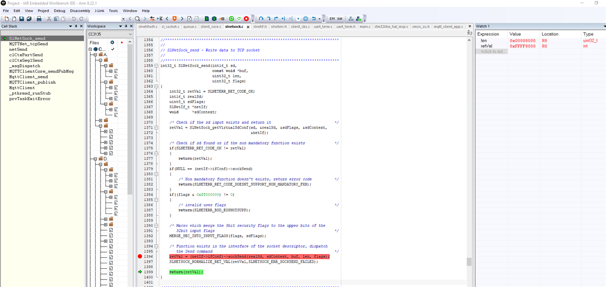

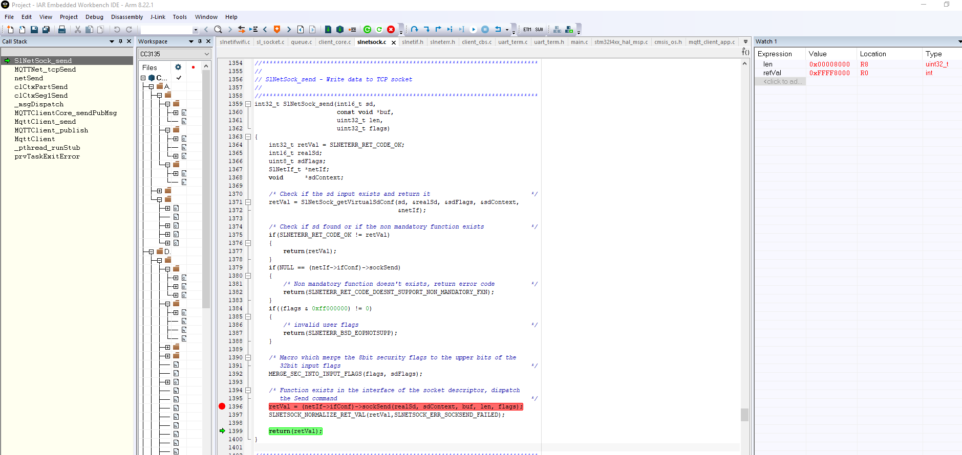

  • Hi
    Sorry for the late response,
    Below a screen shot of my debug case,
    I have just modified the sl_Send function as below, and this, to ignore just the zero length value, and to send the whole packet in only one SPI transmit,
    if(Len == 0) /* (Len < 1) */
    /* ignore */
    return(0);
    and below the result which shows that the returned value is negative number (0xFFFF8000) :
    as you can see, in the Watch tab, the value of len = 0x00008000, contrariwise, the value of the retVal = 0xFFFF8000 and it is treated as an error code in the mqtt library.
    Note that I am using IAR embedded Workbench (version 8.22.1) and I am interfacing the CC3135 Boost-XL module with an STM32 micro-controller.
    I am not sure that the modification of the  SlNetIfWifi_send will solve my issue, the returned value is always defined as int32_t, and it will be automatically converted to negative value. In addition, for throughput purpose, it is better to send data in one shot and not with capped manner.
