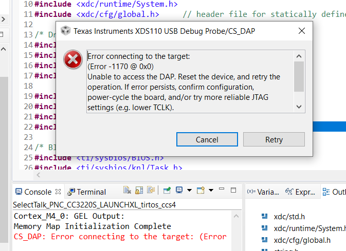

All working well apart from one issue where I get the (common) DAP Error 1170 after building my project in CCS when connecting the Launchpad JTAG (out) signals to my JTAG (in) signals on my board.

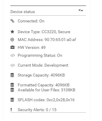

The usual cause I realise is the target being in Production Mode instead of Development mode. This is not the case as I have successfully put the target into Development Mode  and indeed my target system programs successfully using the UART load method.

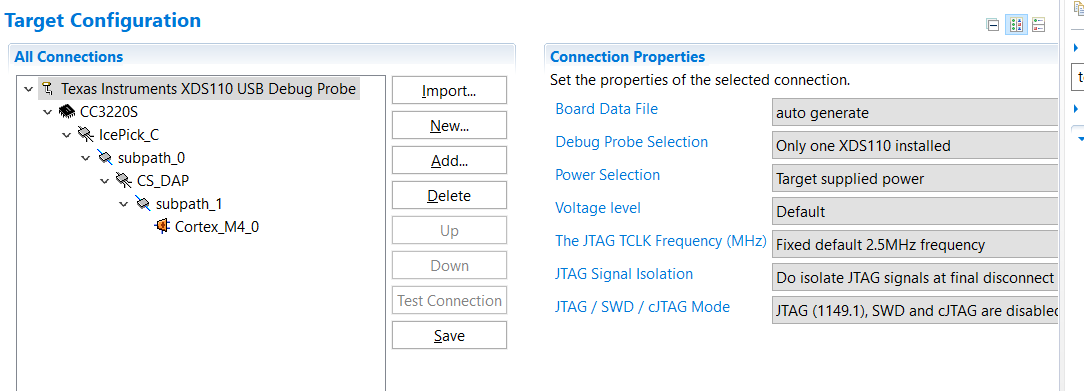

What is strange is that the JTAG integrity connection test (using button 'Test Connection') passes 100% so I'm a bit surprised I get the DAP error after a CCS build and it can't connect to the target. This test I assume means all connectivity is correct (?) I have tried lowering the TCLK frequency to the minimum but still the same issue.
I guess I must be missing a step, any ideas ?

  • Hi Stuart,
    This is pretty strange, I haven't seen such kind of issue before. Please make sure that your JTAG pin connection is correct (proper contact, not too long wires, proper GND connection). If you provide photo with reasonable quality how you have connected your board, I will look on it. Also make sure that you have selected correct SOP mode.
    BTW ... JTAG integrity connection test can return success even in case of JTAG connection is not correct. For example in case you have 4 wire JTAG and you connect TDI+TDO together, test will report success....

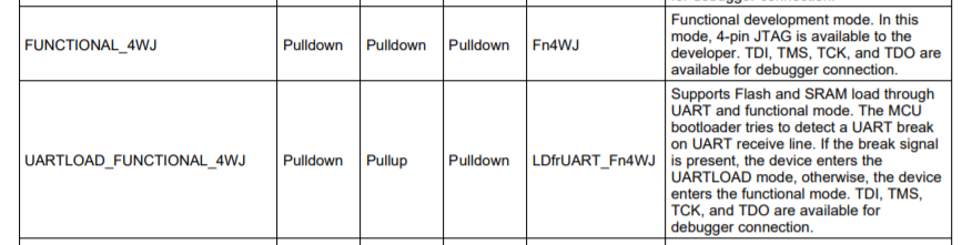

    Ok, I've found the issue while searching the forum (post title below) and its as you allude to in that its the SOP states.
    I still had my SOP at 010 (210) instead of 000 as I just duplicated what was used on the LP (didn't need to change it there). The definitions in the table do confuse me somewhat:
    UARTLOAD_FUNCTIONAL_4WJ works on the LP with CCS so I'm confused why I have to use FUNCTIONAL_4WJ  (000) on my target board ?
    Also do you know what the definition of 'FUNCTIONAL' is ? Is it when the program is loaded from FLASH into SRAM and executed ?
    You issue with SOP mode 010 may to be due to issue with your UART RX line. Please make sure that your RX line is at high during boot. In case is your RX in low or floating. Because this will cause false detection of break signal and device will goes into bootlaoder.
    Yes, that is correct.
