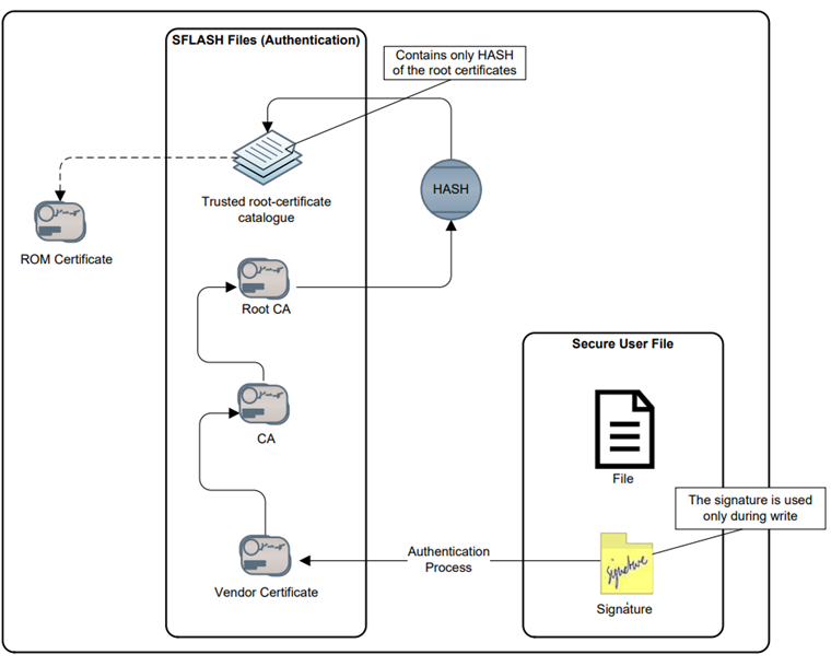

I need to know how secure boot works do we have any documents for that. If demo cose is there please say where. Rest i'll figure it out.
  • Hi Manish,
    The secure boot feature of the CC3220 comes from a variety of security enablers such as the encrypted filesystem, signed binary images, and secure root of trust that when combined allow for a secure boot flow that is fully integrated into the bootloader operation of the CC32xx devices. You do not need to implement or provide any of the secure boot functionality in your application.
    The full description of the various security enablers are explained in the following document:
    https://www.ti.com/lit/swra509
    With the security enablers provided, the secure boot flow is like the following:
    With the integrity checking functioning like so:
    Let me know if you need more clarification on how secure boot works on the CC3220, or have further questions on the various security enablers used.
    Michael
