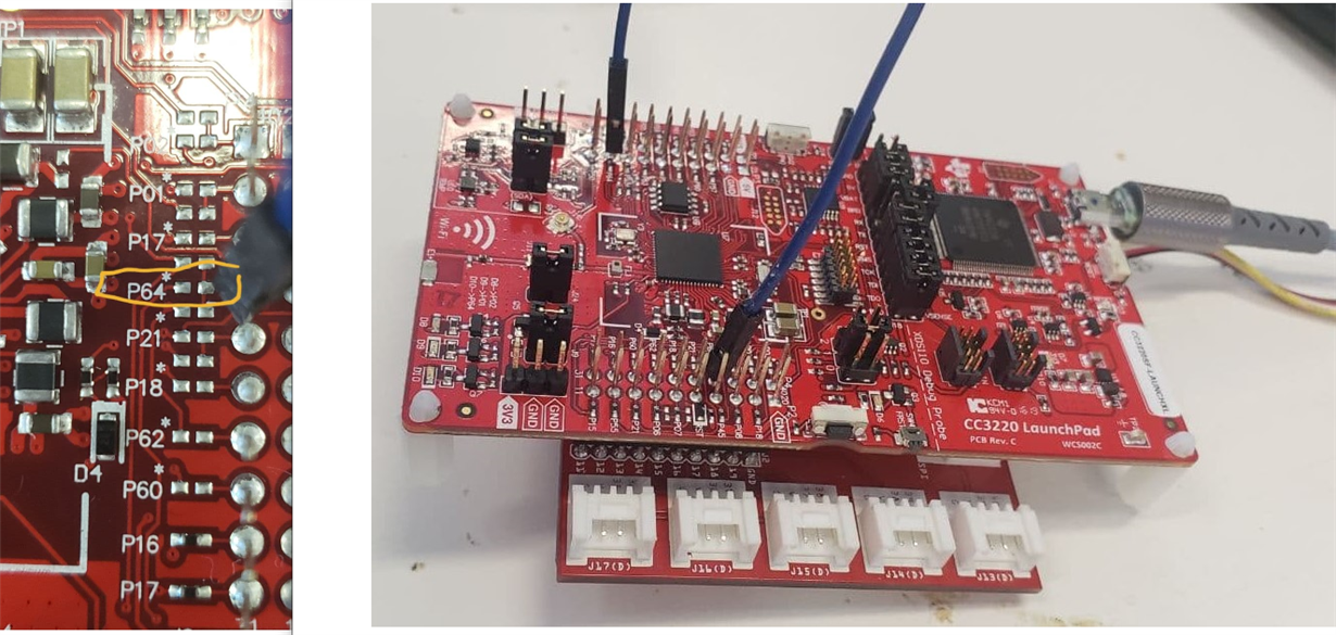

    Please see schematic for LaunchPad. I think it will explain all. Pin P64_GPIO_09 is connected to pin 9 at P3 via 0ohm R90. But there is no physical connection to pin 4 at P4 due to missing R63 which is not populated. If you want to use pin 4 at P4 you need to populate this R63.
    Reason for this is to allow higher flexibility of connecting pins from CC3220 QFN.
    Jan

    It helped a lot. using a multimeter,  I could see pin 9 at P3 has connection with the left side of R63 (the left tiny dot) but It didn't make sense to me.

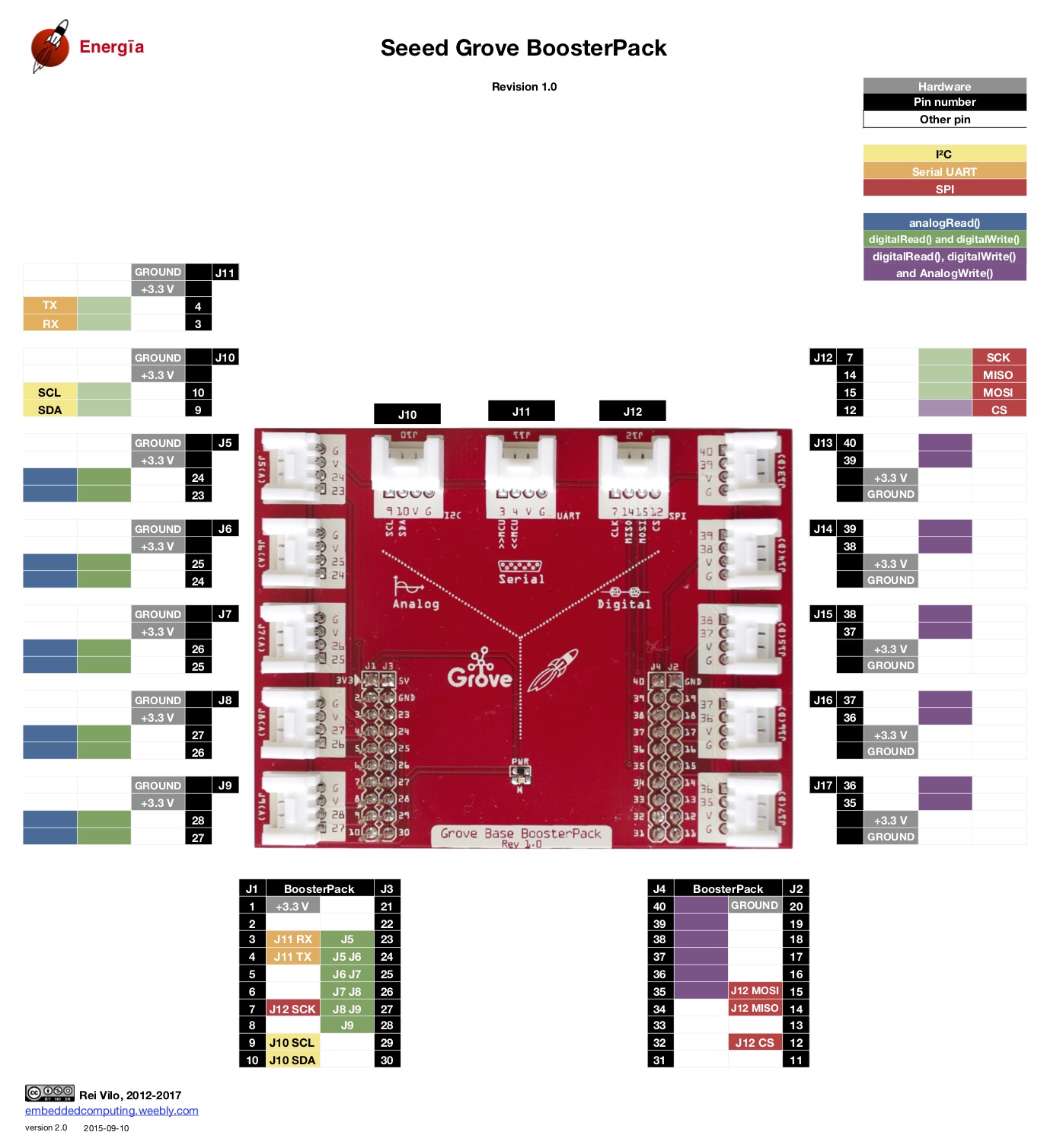

    I am trying to use the GroveBoosterPack (attached is the pinmap) with my board but as can be seen, it doesn't pin out the pin 9 at P3 but it does pin out pin 4 at P4 at J15.
    As I cannot apply any permanent change to the board, I was thinking of just connecting pin 9 at P3 and pin 4 at P4 using a jumper wire instead of populating it.
    That would be great if I can know your opinion on this. [Just trying not to damage this second one :))]

    CC3220SF LaunchPad is designed to capability re-mapping i/o pins to different places of booster pack connector via 0ohm resistors. If you need to change physical connection of pins, there is not much options then using soldering iron. Tinny dots are for DNP 0 ohm resistors.
    Unfortunately I am not familiar with that booster pack and from this reason I cannot give you any advice at this meaner.

    I am thinking of using a jumper wire instead of soldering. when I am checking the connection, pin9 on p3 is now connected to J15 on the grove booster pack but I am a bit worry about turning the board on :))

    Connecting the P64 signal from P3-9 to P4-4 is perfectly fine. The header pin on P4-4 is electrically not connected to anything else, due to the lack of the 0-ohm resistor. In fact, you could safely connect any signal from the board to that header pin if you wanted to. Of course, if you wanted to get the P64 signal out of that header pin, populating that 0-ohm resistor would be all that you need to do.
    Hope that helps answer your question.
