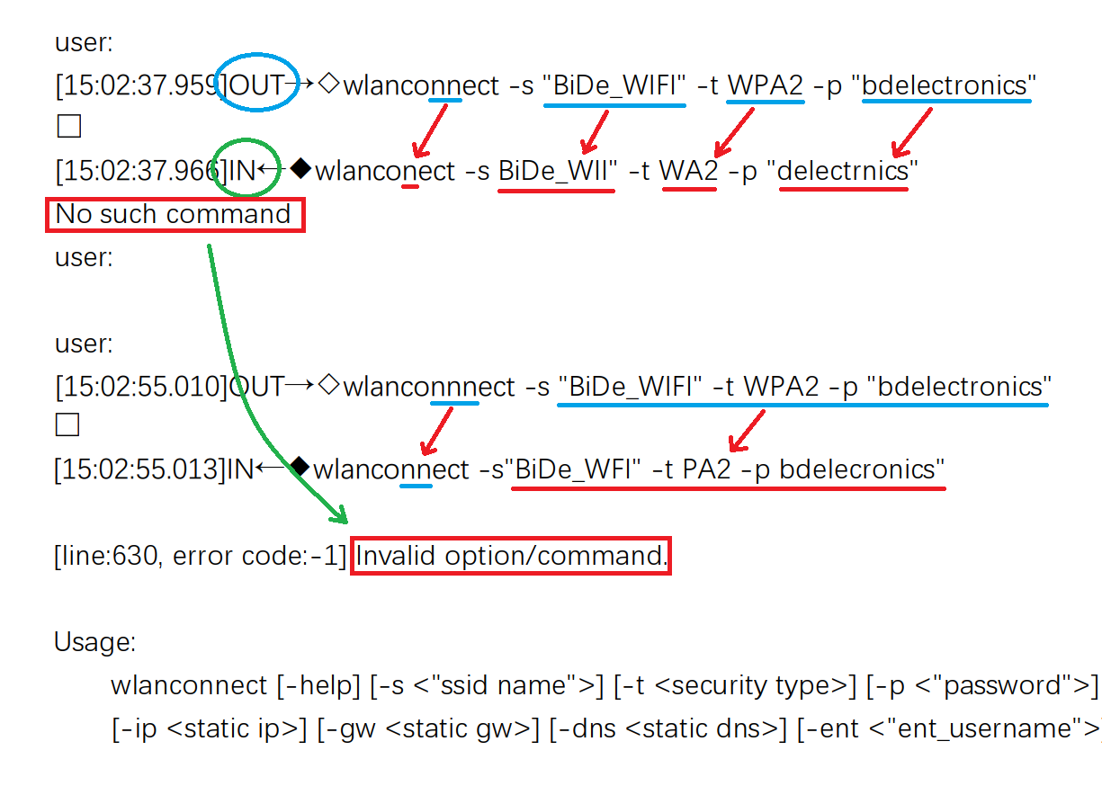

As the log showing above, the command MSP432 received always lost some packets and which lost was/were in random. Like wlanconnect command, it was often recieved as "wlanconect" which will be processed as an invalid command. If I add a "n" and sent "wlanconnnect" that will be recieved as a correct command, but the following packet(s) of parameters will still be lost.

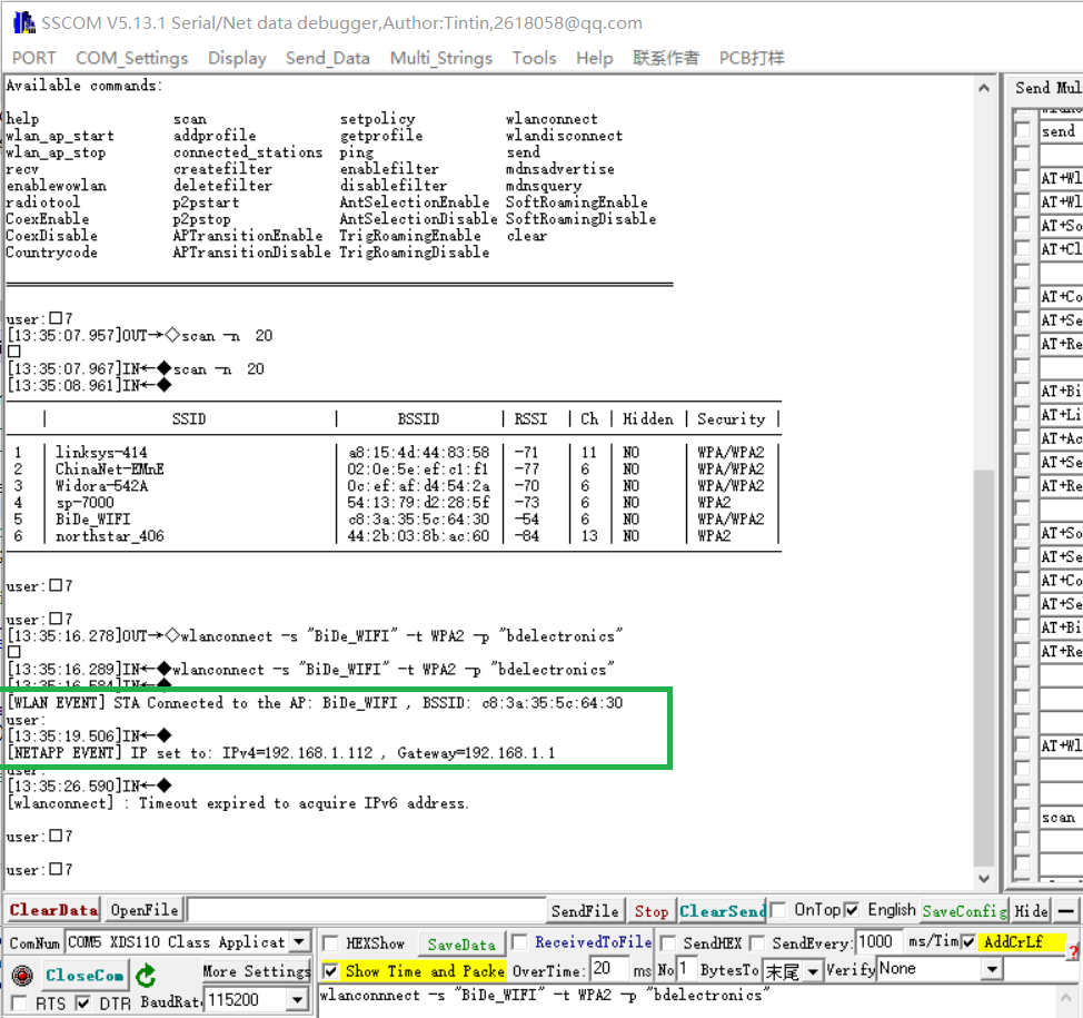

    The following figure is partial screenshot of the log.pdf. "OUT" in blue circle is the command I sent via UART terminal, "IN" in green circle is the data the device recieved. As you can see, there are some characters lost.
    I used SSCOM UART terminal to send command and also tried other terminals such as Serial Debug Assistant from Microsoft Store as shown in the picture below. Unfortunately, the test results are all the same even if I tested on another PC.
    I'm sure the UART terminal sent data properly. I tested the UART terminal many times using CC3235SF LaunchPad with network_terminal project in example folder(D:\TI\simplelink_cc32xx_sdk_4_30_00_06\examples\rtos\CC3235SF_LAUNCHXL\demos\network_terminal\tirtos\ccs), no character lost and the CC3235 connected our router succesfully.
    The following figure is my test result.
    I want to know what caused the loss of characters and how to solve it.
    I'm looking forward to your reply.
    Siemin.
