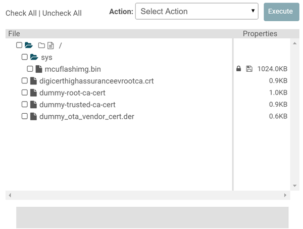

I am having new issues with OTA and I need help understanding the cause. We've had OTA working for a while, but haven't tested it recently, and likely we've caused a regression. I have the following errors:

CdnClient_ConnectServer, Status=-20304 -> OTA_HTTP_CLIENT_ERROR_CONNECT_SL_CONNECT seems to indicate an issue with the connection
However HttpClient_Connect: ERROR Socket Connect, status=-456 -> SL_ERROR_BSD_ESECBADCAFILE seems to indicate an issue with the certificates.
Do you have any insight into what exactly is wrong with the CA file? The OTA image is essentially the same as the flashed image, so it seems like the CA file should match, but it's possible I've got something wrong in creating the files after recently having lost my Uniflash configuration settings.
Right now we're just using the TI dummy certificates
Katie
  • -456 means that either the certificate format is wrong (less likely) or the file wasn't found (i.e. wrong path or file name).
    Make sure the Dropbox server's root CA (Digcert High Assurance CA) is programmed in flash and that the otauser.h points to the right path+file name.
    Br,
    Kobi
  • Ok that makes sense, and it IS missing. Unfortunately, we can't seem to find our original copy of the file to be able to add it. However, I do have a separate project in Uniflash that has those included in the file system (but that project seems to be broken for other reasons.) It appears Uniflash is grabbing that file from somewhere on my system given that I don't have to reload it every time. Do you know where Uniflash saves a local copy of the User Files we've added?
    Katie
  • Ok, I was able to get our files (and save them somewhere safe) by hovering over the files and doing Get.
    But I am still not successful. Here are my new errors:

    HttpClient_Connect: WARNING Socket Connect, status=-468 -> SL_ERROR_BSD_ESECUNKNOWNROOTCA
    OTA_run: ERROR CdnClient_ReqOtaDir, Status=-20310 -> OTA_HTTP_CLIENT_ERROR_RESP_STATUS_NOT_OK
    Katie
  • The -468 is a warning that means the root CA can't be verified by the certificate catalog (i guess you are using the dummy playground catalog so the DigiCert certificate is not recognized). Anyway this is a warning only and the connection is still open.
    The problem is that you got HTTP Error 409, trying read the folder list.
    Did you open a new Dropbox App? if so make sure your token is set with "no expiration" and that the read permissions are enabled.
    Try to generate a new token and use it in your otauser.h (changing otauser.h requires that you rebuild your lib and app).
    Br,
    Kobi
  • You're correct that we're still using the dummy playground catalog for now.
    We tried with a new Dropbox token and get the same errors. We can't think of anything that has changed on the Dropbox side.

  • Ok, we originally had
    #define OTA_SERVER_ROOT_CA_CERT         "digicerthighassuranceevrootca.crt"
    which had worked fine for the past year and is included in the file system. When we change that to
    #define OTA_SERVER_ROOT_CA_CERT         "DigiCertGlobalRootCA.crt"
    and include it in the file system, it seems to want our original cert:

  • It seems that you find a new issue.
    In the OTA process, the library actually connects to 2 servers. It first connects to the Dropbox CDN server, where it uses the token to get access to your app folders and find the (TAR) file to download. Once the tar file is found the library requests its URL (iwithin the Dropbox' file server).
    The library then opens a second (HTTPS) connection to the file system to load the file.
    Until now both servers (the CDN and File) always used the same certificate (DigiCertGlobalRootCA.crt).
    It seems that now the file server uses a different one.
    We will add a fix in one of the next SDKs, but in the meanwhile you can try the following fix (for the "ota" library):
    1. store the 2 root ca certificates in the file system: "DigiCertGlobalRootCA.crt" and "digicerthighassuranceevrootca.crt"
    2. in "otauser.h" - add a second definition as follows:
    #define OTA_FILE_SERVER_ROOT_CA_CERT   "DigiCertGlobalRootCA.crt"
    3. in "OtaHttpClient.c" - update the definition of HttpClient_Connect() so it will get the certificate as a parameter (currently it always uses the OTA_SERVER_ROOT_CA_CERT ). The header file should be updated accordingly:
    int16_t HttpClient_Connect(uint8_t *ServerName, int32_t IpAddr, int32_t Port, int32_t Secured, char *rootCaCert, int32_t NonBlocking)
    update (line110) :
    Status = sl_SetSockOpt(SockId, SL_SOL_SOCKET, SL_SO_SECURE_FILES_CA_FILE_NAME, rootCaCert, strlen(rootCaCert));
    4. in "CdnClient.c": update the CdnClient_ConnectServer() and CdnClient_ConnecFiletServer()
    int16_t CdnClient_ConnectServer(CdnClient_t *pCdnClient, Ota_optServerInfo *pOtaServerInfo)
    update (line 57) :
    pCdnClient->ServerSockId = HttpClient_Connect(pOtaServerInfo->ServerName, pOtaServerInfo->IpAddress, SOCKET_PORT_DEFAULT, pOtaServerInfo->SecuredConnection, OTA_SERVER_ROOT_CA_CERT, SOCKET_BLOCKING);
    int16_t CdnClient_ConnectFileServer(CdnClient_t *pCdnClient, uint8_t *pFileUrl, int32_t SecuredConnection)
    update (line 150):
    pCdnClient->FileSockId = HttpClient_Connect(ServerNameBuf, 0, pCdnClient->PortNum, SecuredConnection, OTA_FILE_SERVER_ROOT_CA_CERT, SOCKET_BLOCKING);
    Br,
    Kobi
  • That worked!
