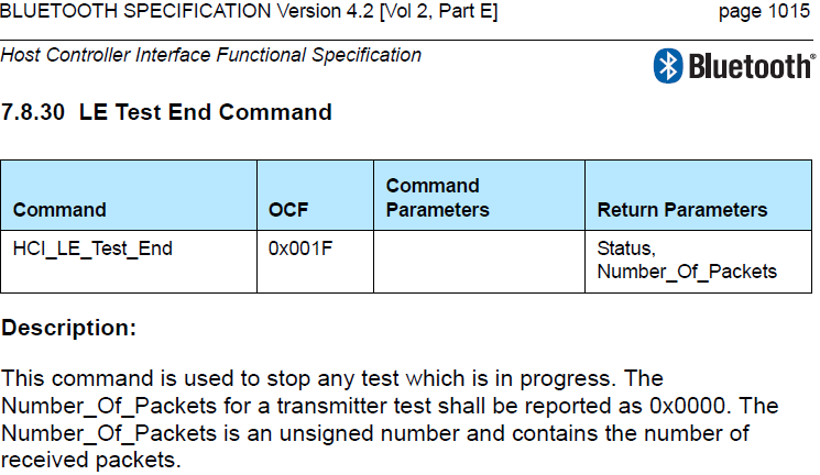

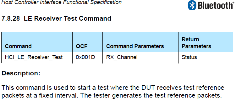

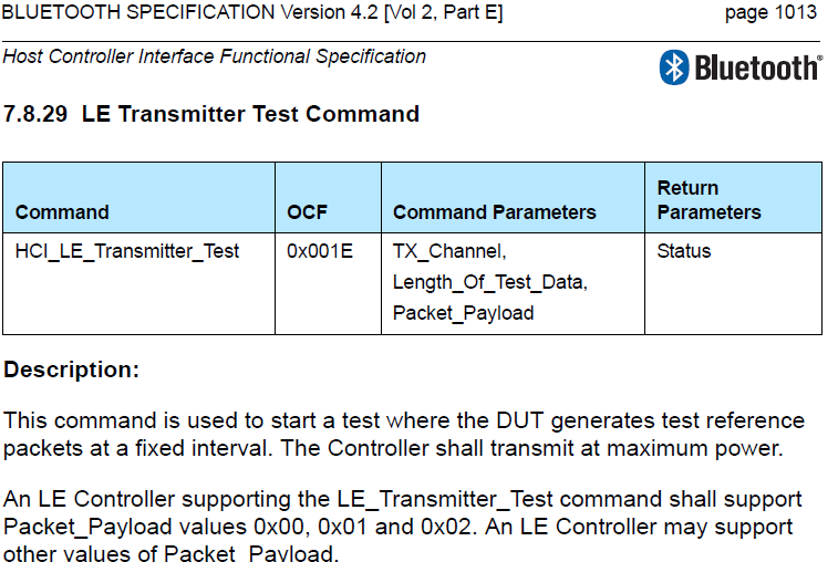

1. For the above, I have tried with HCI commands extracted from Bluetooth Core 4.2 as shown below:
Rx:
hcitool -i hci0 cmd 0x08 0x001D 0x00
Tx:
hcitool -i hci0 cmd 0x08 0x001E 0x00 0x25 0x04
Test End:
hcitool -i hci0 cmd 0x08 0x001F
Once I send the command to end the test, the command effectively returns to me the number of returned packets on the receiver side. However, I need to have control over what is sent, that is, I need to have a command that can limit the number of packages that are sent from the Tx unit.

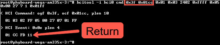

  • Hi Hari,
    yes, even for almost all commands I use the conversion. I tried to do the conversion to hcitool format but when I send these commands I receive the error code 11 (0x11 - the one related in point 2 of my first post).
    Here is an example taking the command:
    Send_HCI_VS_DRPb_Tester_Packet_TX_RX 0xFDCC, 0x5, 3, 2402, 0xFFFF, 5, 0, 339, 5, 1, 0x01FF
    the OPCODE is 0xFDCC, to use it with hcitool format, we have OGF 0x3F and OCF 0x01CC for which I send the command and return this:
    After looking at the list of error codes in the Bluetooth Core 4.2 document, I find that a return of 0x11 corresponds to "UNSUPPORTED FEATURE OR PARAMETER VALUE (0x11)
    Q1. Do you have any idea why I'm getting this error when I use the above command?
    Thanks!
  • I don't know why in my previous post the image didn't load correctly,
    so, the image with my command and the response is that:
    Thanks!
  • You would need to provide the parameters as byte array for these commands.. Please, see below..
    (Send_HCI_VS_DRPb_Tester_Packet_TX_RX 0xFDCC, 0x5, 3, 2402, 0xFFFF, 5, 0, 339, 5, 1, 0x01FF)
    root@am335x-evm:~# hcitool -i hci0 cmd 0x3f 0x01cc 0x05 0x03 0x62 0x09 0xff 0xff 0x05 0x00 0x53 0x01 0x05 0x01 0xff 0x01
    < HCI Command: ogf 0x3f, ocf 0x01cc, plen 14
      05 03 62 09 FF FF 05 00 53 01 05 01 FF 01
    > HCI Event: 0x0e plen 4
      01 CC FD 00
    root@am335x-evm:~#
