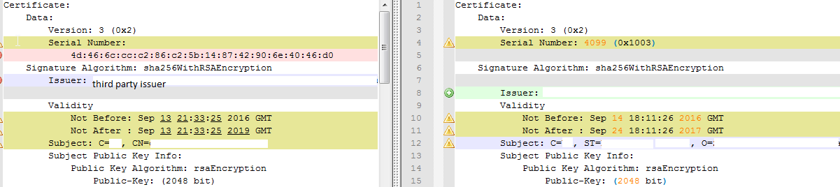

I have CC3200 worked as the tcp server with secured sockets.
I generated third-party certificate and trying to set it up on my CC3200 but with no success so far.
At the same time, self-signed certificate works ok.
I have checked my third-party certficate by installing it on the server and checking md5 hash it seems pretty ok but when I
try to connect to CC3200 with my client code it prompts me with the following error:
javax.net.ssl.SSLHandshakeException: Remote host closed connection during handshake
at sun.security.ssl.SSLSocketImpl.readRecord(SSLSocketImpl.java:953)
at sun.security.ssl.SSLSocketImpl.performInitialHandshake(SSLSocketImpl.java:1332)
at sun.security.ssl.SSLSocketImpl.startHandshake(SSLSocketImpl.java:1359)
at sun.security.ssl.SSLSocketImpl.startHandshake(SSLSocketImpl.java:1343)
at play.sockets.ssl.Client.main(Client.java:61)
Caused by: java.io.EOFException: SSL peer shut down incorrectly
at sun.security.ssl.InputRecord.read(InputRecord.java:482)
at sun.security.ssl.SSLSocketImpl.readRecord(SSLSocketImpl.java:934)
... 4 more
CC3200 can't even send this certificate to client
May be the problem with the conversion I used while preparing cert for flashing.
What I've got from the vendor is the file content like:
-----BEGIN CERTIFICATE-----
-----END CERTIFICATE-----
I tried to convert it to DER both ways as complete file and as part which is my certificate only but result is the same.
Thanks for any suggestions.
