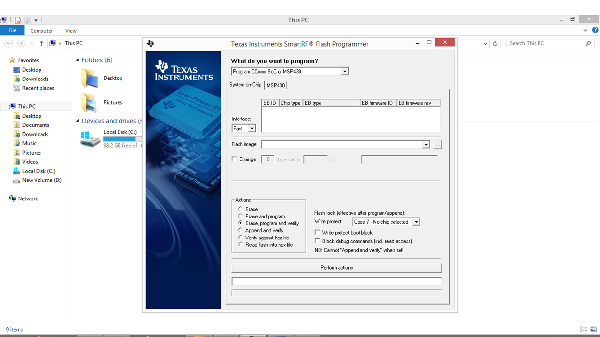

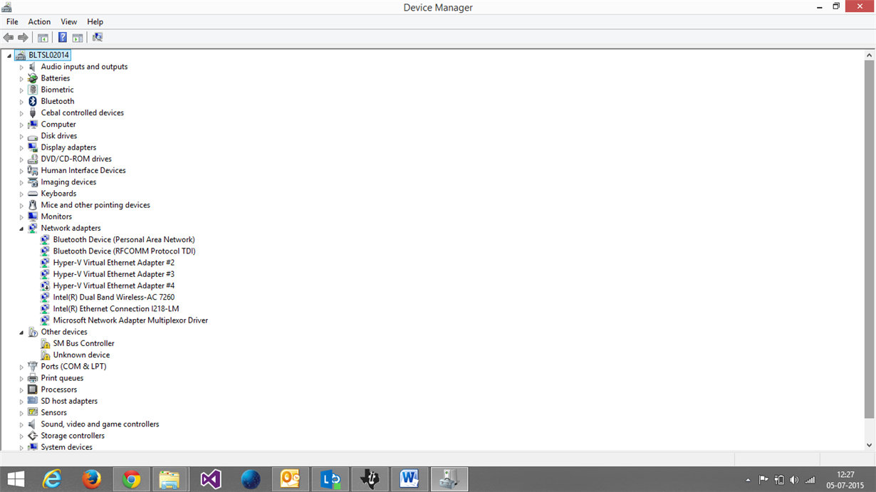

    I tried to upgrade CC2531 USB dongle using CC Debugger and SmartRF Flash programmer. When I plug in the CC Debugger to Host machine USB, SmartRF tells me it needs to updgrade the firmware which I did and after that it does not recognize the CC debugger any more.
    Packet Sniffer tool is listing CC2531 dongle.
    When I connect CC Debugger to CC2531 I have green light on CC Debugger LED, so drivers seems fine, but tool does not detect CC2531.
    Please help.

    Then, once you've connected your CC-debugger to a PC, run the flash programmer.
    When in flash programmer, choose "program evaluation board" from the drop down menu (shown in the attached figure),
    does it shows CC-debugger parameters? If you do see CC-debugger parameters, you can reprogram it with this FW: cebal_fw_srf05dbg.zip
  • Device does not show up even under "program evaluation board".

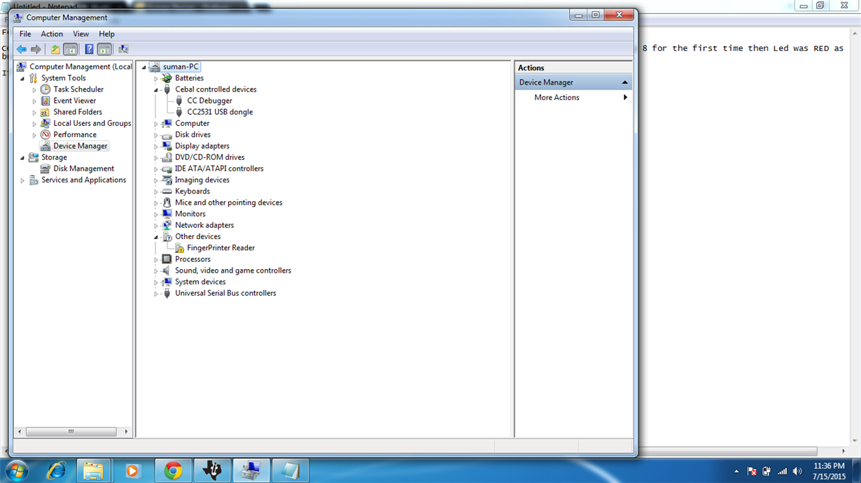

  • Following the instructions given in Sec 8 I was able to recover CC Debugger and it started appearing in SmartRF Tool as well.
     CC Debugger Led is always RED even though device manager shows cebal driver loaded properly. Also, When I did reset using step 8 for the first time then Led was RED as well,but then I pressed Reset button and it turned GREEN. Repeating the same procedure is not resulting in Led turning Green.
    If I connect CC2531 now to PC it gets enumerated in device manager as CC2531 USB dongle, but both RED and GREEN Leds are glowing here. After sometime it turns RED completely.
    How can I reset CC2531 now ?
    Why is RED led glowing on CC Debugger when everything seems fine at driver and SmartRF tool level ?
  • You can unplug CC2531 USB dongle from USB port and plugin again to reset it. CC Debugger LED only turns GREEN when you press the button and a CC2531/CC2530 is connected.
  • I didn't mean restart. By Reset I meant how to restore CC2531 to factory settings. Is there a way to short circuit CC2531 like CC Debugger ?
    CC Debugger LED is RED even after connecting it with CC2531. I pressed Reset button multiple times in CC Debugger while it is connected with CC2531, but LEDs never turn GREEN.
    Strangely, as you can see in the pictures I posted, both drivers gets enumerated correctly when plugged to host machine USB ports.
