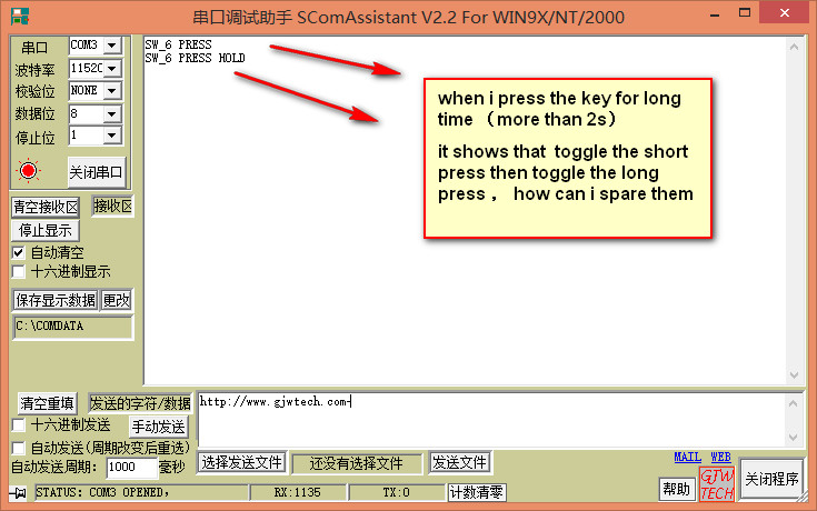

    Secondly  as add those code , when i press the key , it always toggle short press event then toggle long press event

    static void zclIASZoneVibration_HandleKeys( byte shift, byte keys )
      if ( keys & HAL_KEY_SW_6 )
    #ifdef KeyHoldCheckByCompare
          KeyPressCnt =0;
          HalLedBlink ( HAL_LED_4, 0, 50, 2000 );
          HalUARTWrite(0,"SW_6 PRESS\n", sizeof("SW_6 PRESS\n"));
          osal_start_timerEx( zclIASZoneVibration_TaskID, KEYHOLD_EVT, 1000);
    #endif
    as the result of press key long time, there is always toggle the short press event, how can i  avoid  this bug:
  • Hi  chen
                if i  set this function osal_start_timerEx( zclIASZoneVibration_TaskID, KEYHOLD_EVT, 1000);
    is the event loop judgement , the device will be always working, which is not good for setting sleep mode
  • You can revise the red lines to seperate "SW_6 PRESS" and "SW_6 PRESS HOLD"
      if ( events & KEYHOLD_EVT )

  • The device will not be always working with osal_start_timerEx( zclIASZoneVibration_TaskID, KEYHOLD_EVT, 1000);. It would sleep 1 second and wake up after time is up.
  • oh no!!
    this enddevice is powered by battery ,and it was the IAS_ZONE,
    if the device wake up every 1s , the battery will be loss power soon。
  • In my example, I only start event every second when the button is hold. If you don't hold the button, the device won't be wake up every second.
  • ok i see , you mean if there is not any keypress the device will sleep all the time ,if key press and hold this wake up event will be start  then again and again , when key release,the wake up event will stop , is that right !??
    but there is a problem,when short key press occurs ,it seems need to wait so long  then toggle the short press event 。
  • 1. It is correct that the event would only be created when key is pressed and hold.
    2. You can shorten the delay (from 1000 to 100) of first call to osal_start_timerEx in zclIASZoneVibration_HandleKeys(). Then, you don't have to wait 1 second.
          KeyPressCnt =0;
          osal_start_timerEx( zclIASZoneVibration_TaskID, KEYHOLD_EVT, 100);
    #endif
  • hi chen ,i think that is wrong.
    i have change it as you said, but it didn't work.
    so i have try change  the long press event wake up cycle as like this :
         if ( HAL_PUSH_BUTTON1())//key long press
          KeyPressCnt++;
          if(KeyPressCnt >=30)
            HalLedSet ( HAL_LED_4, HAL_LED_MODE_OFF );
            HalUARTWrite(0,"SW_6 PRESS HOLD\n", sizeof("SW_6 PRESS HOLD\n"));
          else
         else // key short press
        return ( events ^ KEYHOLD_EVT );
    and  this method worked
  • Yes, your revision works better.
