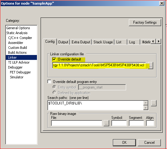

    I have downloaded the IAR work bench for MSP430.  And i am using SampleApp - ESP - Coordinator.
    1. In the process of compilation i got the following errors.
    Fatal Error[e72]: Segment ZIGNV_ADDRESS_SPACE must be defined in a segment definition option (-Z, -b or -P)
    Error while running Linker
    2. By reading few blogs, I realized the linker file .xcl to be modified or path to be changed according the project.
    So, Now i am using the "MSP430F5438.xcl" linker file under the path "C:\Texas Instruments\Z-Stack Energy 1.1.0\Projects\zstack\Tools\MSP5438".
    3. After the changes above error got solved but i got new error as below
    Fatal Error[e72]: Segment CODE_I must be defined in a segment definition option (-Z, -b or -P)
    Please help me to resolve the problem, and if you have any compiled code.  Please provide the .xcl linker file and please provide the memory map file.

  • Hi Yikai chen,
     i am using SampleApp - ESP - Coordinator. But i am getting below errors.
    Thanks and regards,
    Santhosh Kumar V
  • Z-Stack Smart Energy 1.1.0 use IAR EW430 version 5.51.6 as its IDE. I suggest you to download IAR EW430 version 5.51.6 from processors.wiki.ti.com/.../IAR_Embedded_Workbench_Kickstart_for_TI_MSP430_Release_Notes to build it.
  • After using  EW430 version 5.51.6 as its IDE, the example softwares(sample app) are working fine. Thank you very much.

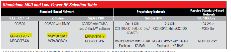

    I have one more doubt/question.
    According to the document "MSP430™ MCUs, Passive RF and Low-Power RF Solutions Guide" - sly265f.pdf
    It as mentioned MSP430f261x supports Zigbee and Zigbee PRO.   But the minimum requirement of the Z-stack seems to be as be below (generated from map file)
    112 042 bytes of CODE  memory
     12 630 bytes of DATA  memory (+ 136 absolute )
      5 075 bytes of CONST memory;
    But the memory available in  MSP430f261x in 116kb Flash and 8Kb of RAM.  So, available memory is less then the required memory.
    Can you please help me to understand the above conflict.
  • When you build this, do you set IAR optimization to High "Size"?
  • I suppose old version of TIMAC might be able to fit into MSP430F261x. However, the latest TIMAC 1.5.2 might not and that's why it only provide MSP430EXP5438 example.

  • I guess this is an obsolete document. When it was published, I think Z-Stack can be fitted into MSP430f261x. With latest Z-Stack, MSP430f261x is not enough that's why you only see example using MSP430EXP5438.
