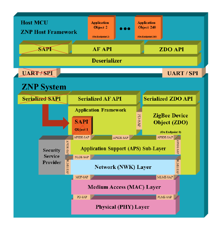

  • Dear Jason and YK,
    Sorry for my unclear explanation. I am going to describe my issues in details here:
    I found there is a SAPI task in the ZNP example (SAPI_ProcessEvent)(C:\Texas Instruments\Z-Stack 3.0.0\Projects\zstack\ZNP)  while other examples in HomeAutomation (C:\Texas Instruments\Z-Stack 3.0.0\Projects\zstack\HomeAutomation) don’t have it.
    My questions are:
    1. Can I remove the SAPI in that ZNP program? In such a way that the architecture of the ZNP-ZAP configuration would be like this? (I marked some crosses on the figure.)
    2. I found the Z-Stack 3.0’s document folder (C:\Texas Instruments\Z-Stack 3.0.0\Documents) don’t have SPAI document (Z-Stack Simple API.pdf), does it mean that the SPAI will be deprecated  soon?
    Thank you.
    BR,
    Barry
  • 1. It's no problem to remove SAPI if you don't use it.
    2. If you use Zigbee 3.0, SAPI is useless.

  • If you run Zigbee 3.0 application, it would use BDB or ZDP APIs. SAPI is for simple none Zigbee standard profile applications.
