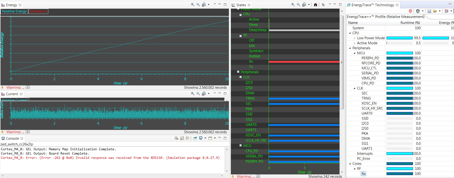

I try to use energy trace of CCS to monitor power consumption issue when running simplelink_zigbee_sdk_plugin_2_20_00_06 zed_switch on LAUNCHXL-CC26X2R1. I find a strange behavior is that zed_switch consumes 2.69mA (1st attached screen shot) after zed_switch starts and hasn't join any network. I try to switch to EnergyTrace+[CPU State]+[Peripheral State] and I find RX is not turn off. You can refer to the second attached screen shot. Can TI help to check if this is a bug in simplelink_zigbee_sdk_plugin_2_20_00_06? I expect power consumption of zed_switch should be less than 3 uA when it hasn't joined any Zigbee network.

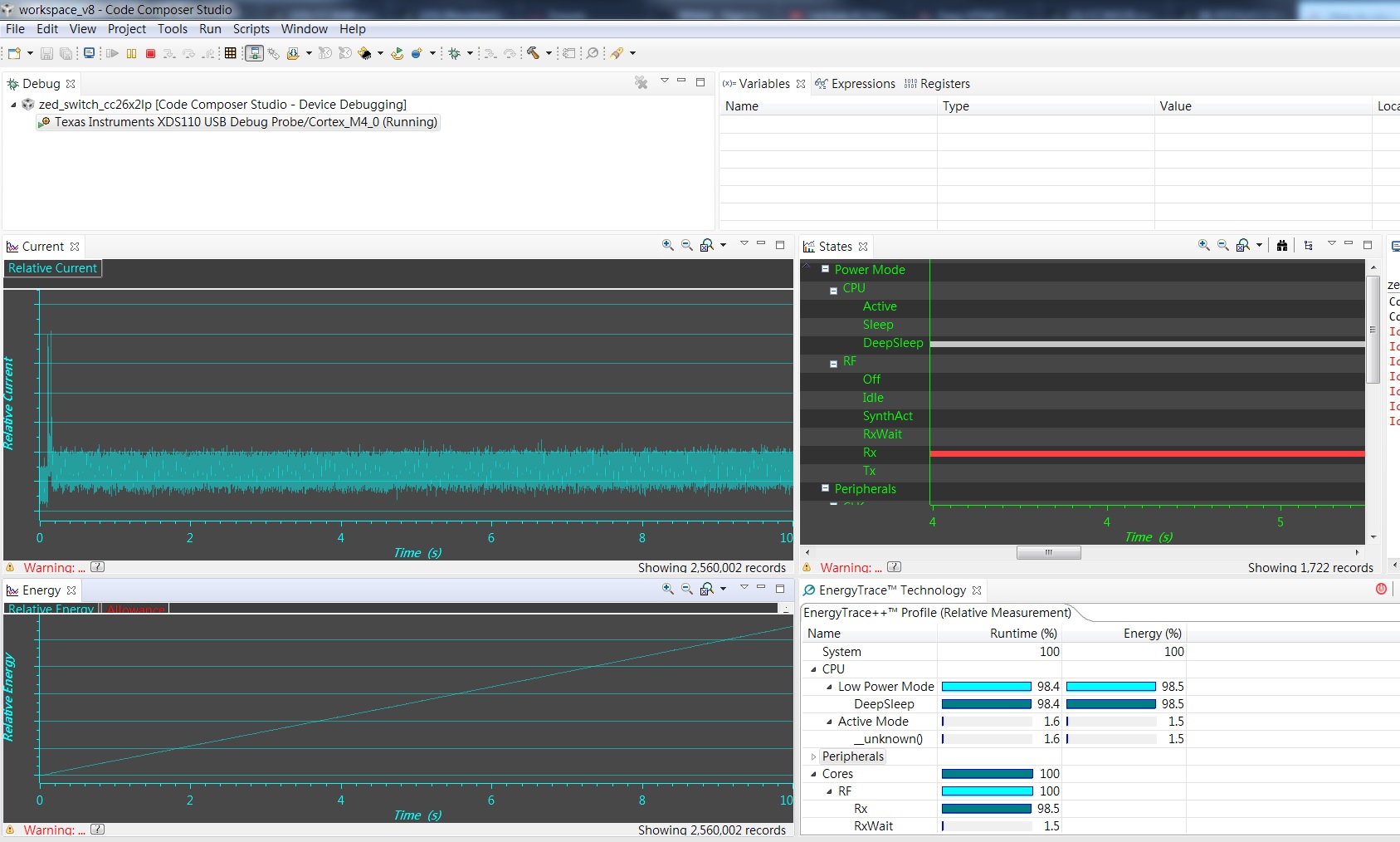

  • 1. I define POWER_MEAS, POWER_SAVING, ZED_POWER_CONSUMPTION_WORKAROUND, remove BOARD_DISPLAY_USE_UART, and add Board_shutDownExtFlash() to main.c
    2. Since energy trace need JTag which usesTDO/TDI so I can only remove 5V, RXD/TXD, SWO jumpers. I also power the MCU externally.

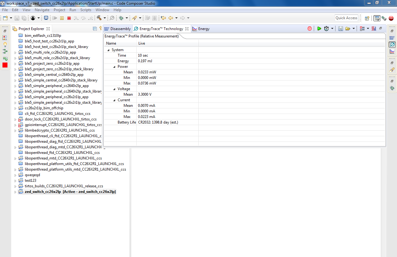

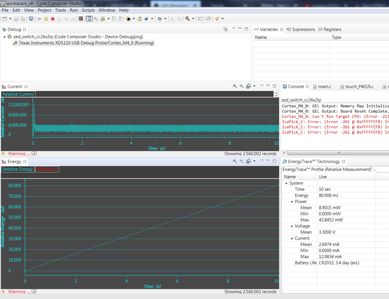

    After I free run the project, I see the mean current is 0.002mA but I see it shows 3mA on my power supply to power LAUNCHXL-CC26X2R1 externally. If you look at my new attached energy trace screen shot, you can see RX is still not turn off after device is power on and doesn't join any Zigbee network. I think those defines doesn't fix the issue and please help to verify this from your side. Thanks.

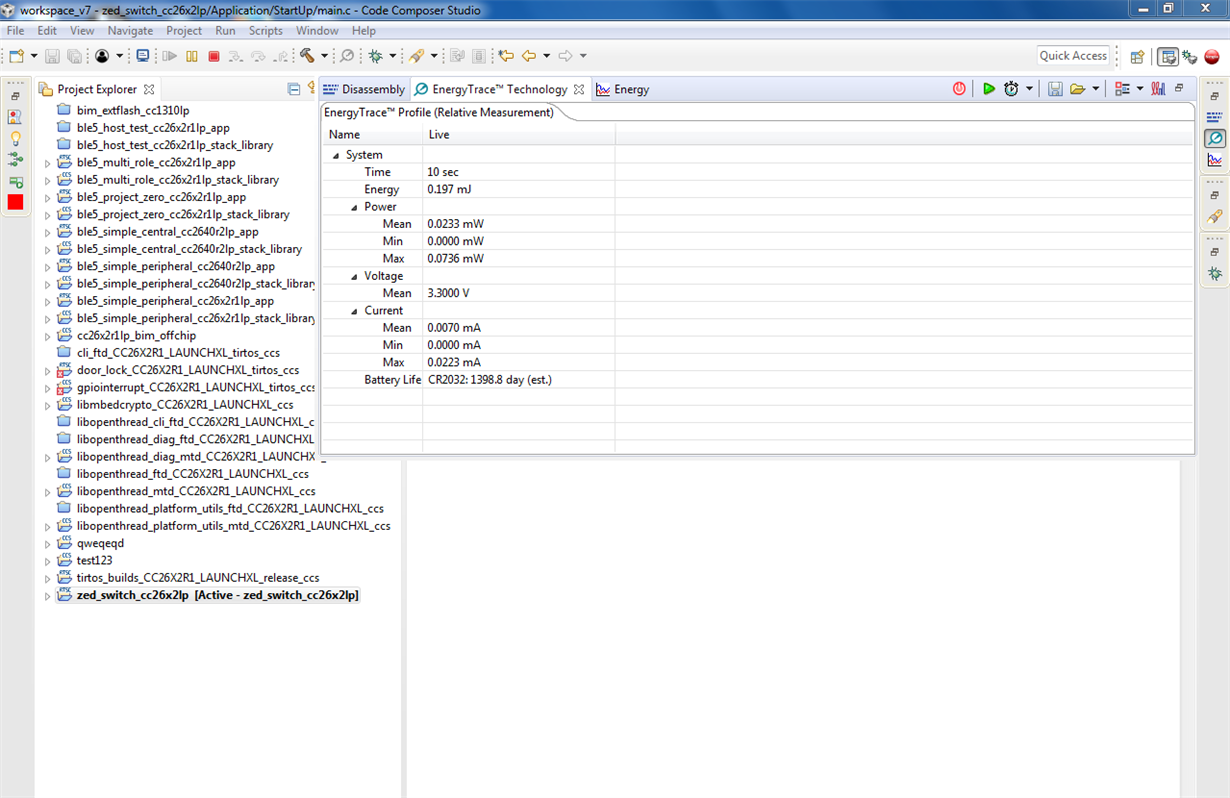

    Please check my test screen shot. You hope you test  in simplelink_zigbee_sdk_plugin_2_20_00_06. .

  •  Just test your latest patch and it doesn't work too. I still see RX is on in energytrace after device starts.

  • I revise the following red codes and test it. However, I still see the same problem. Do I miss anything?
