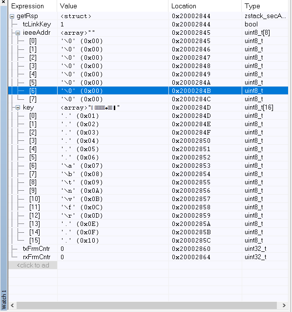

  • Hi  Philipp,
    The issue with your code is that you are looking to remove get, set and remove the key with ieeeFlashAddr equal to (void *) 0x500012F0. TCLK is stored in ZCD_NV_TCLK_TABLE_START NV item with IEEE address value of 0xFFFFFFFFFFFFFFFF in APSME_TCLinkKeyInit(), this is in ZDSecMgr.c, so you need that value to initially manipulate this element with the get, set or remove API's, then the API's will store your new key with IEEE value of 0x0000000000000000. I made some changes to your code to make it work with the provided API's. You still need the fixes provided by Dalila.
    Use the next code to test the API's:
      uint8_t ieeeFlashAddr[Z_EXTADDR_LEN];
      uint8_t newTCLinkKey[SEC_KEY_LEN] = { 0x01, 0x02, 0x03, 0x04, 0x05, 0x06, 0x07, 0x08,\
                                                 0x09, 0x0A, 0x0B, 0x0C, 0x0D, 0x0E, 0x0F, 0x10 };
      zstack_secApsLinkKeyGetReq_t getReq = {0};
      zstack_secApsLinkKeyGetRsp_t getRsp;
      zstack_secApsLinkKeyRemoveReq_t rReq = {0};
      zstack_secApsLinkKeySetReq_t pReq = {0};
      zstack_ZStatusValues  ret;
      memset(ieeeFlashAddr, 0xFF, Z_EXTADDR_LEN);
      getReq.tcLinkKey = true;
      memcpy(&(getReq.ieeeAddr),ieeeFlashAddr,Z_EXTADDR_LEN);
      ret =  Zstackapi_secApsLinkKeyGetReq(ztsEntity,
                                              &getReq,
                                              &getRsp);
      rReq.tcLinkKey = true;
      memcpy(&(rReq.ieeeAddr),ieeeFlashAddr,Z_EXTADDR_LEN);
      ret = Zstackapi_secApsLinkKeyRemoveReq(ztsEntity, &rReq);
      memset(ieeeFlashAddr, 0x00, Z_EXTADDR_LEN);
      pReq.tcLinkKey = true;
      memcpy(&(pReq.ieeeAddr),ieeeFlashAddr,Z_EXTADDR_LEN);
      memcpy(&(pReq.key), &(newTCLinkKey), SEC_KEY_LEN);
      ret = Zstackapi_secApsLinkKeySetReq(ztsEntity, &pReq);
                                              &getReq,
                                              &getRsp);
    So the API's work as expected you just need to take care of the IEEE you are using to request the TCLK.

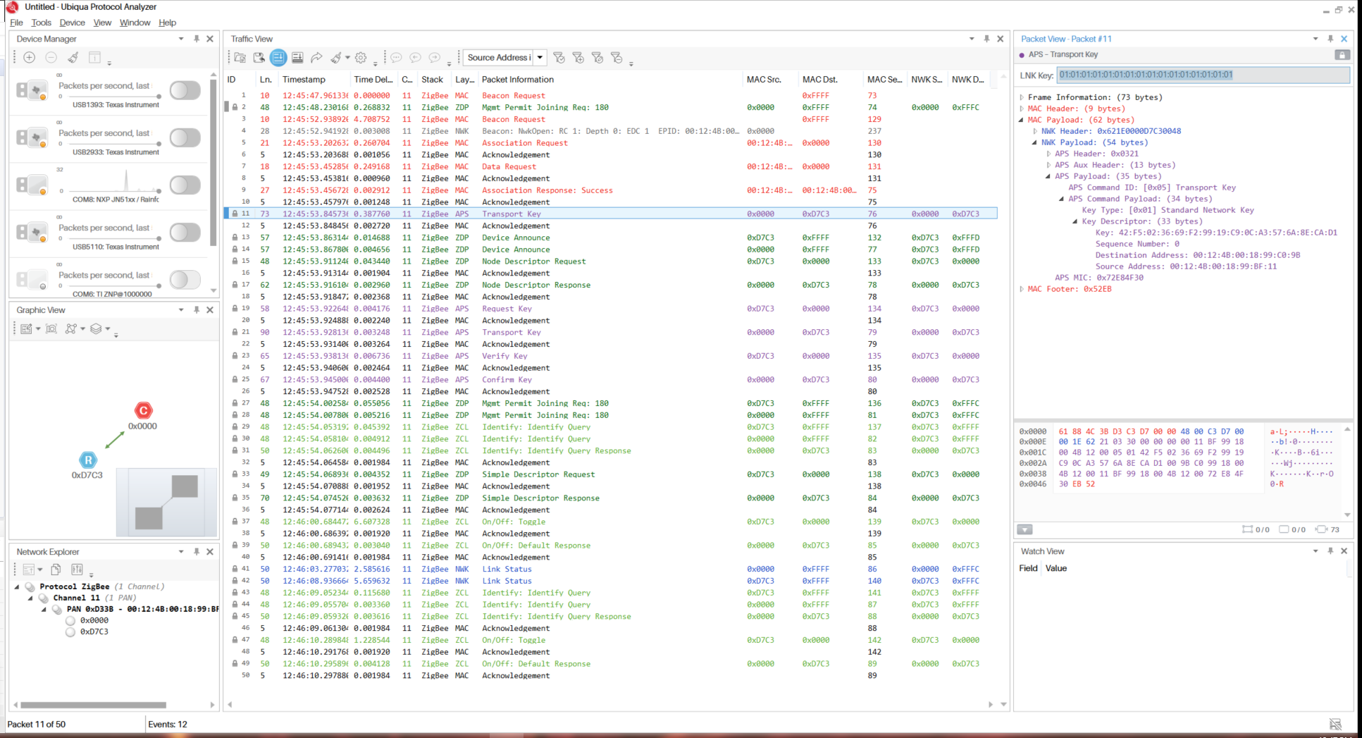

  • Hey Philipp,
    Please convert your .isd to .dcf so that we can view the sniffer log in Ubiqua.
    Ryan
  • Hi Ryan,
    I converted the File, once with forced Ubiqua DC format and once conform to original Daintree specification.
    Philipp
    5126.DSLK.zip
  • Can you tell the device and application used for Zigbee coordinator in this sniffer logs?
  • The Device is a Telegesis ETRX3USB+8M with a Firmware based on the stack version EmberZNet 5.4.0.
  • From the sniffer log is clear that the Zigbee coordinator is sending the transport key encrypted with the default TCLK 5A:69:67:42:65:65:41:6C:6C:69:61:6E:63:65:30:39 (look at packet 21). Since you have changed the default TCLK of your End Device to 10:0F:0E:0D:0C:0B:0A:09:08:07:06:05:04:03:02:01 this device is not able to decrypt the transport key frame and the association process cannot be completed. You need to change the default TCLK of coordinator as well.
  • My bad I sent the wrong logs. These are the ones with the NWK key correctly encrypted. We used the following key in the code:
    uint8_t newTCLinkKey[SEC_KEY_LEN] = { 0x64, 0xE9, 0x12, 0x9D, 0xE2, 0x7C, 0xE3, 0x85,\
    0x8E, 0x4C, 0xE1, 0x23, 0xF9, 0x8C, 0x72, 0x86 };
    And the same can be seen as encryption for the NWK key in the logs.
    DSLK_Joining.zip
  • I'm not able to decrypt the trasport key frame on packet 56 in the log with this TCLK. Can you double check the value of the key for coordinator.
                                             &getReq,
                                             &getRsp);
    Ieee address needs to be 0xFFFFFFFFFFFFFFFF for Zstackapi_secApsLinkKeySetReq(), I just noticed this typo, sorry about that.
    Now you will be able to decrypt the transport key an see something like this.
  • Hi Jose,
    when I try to write to 0xFF I get a zstack_ZStatusValues of 0x09 returned. This value is not defined in the Enum, thus I'm not sure what this error means.
    Philipp
