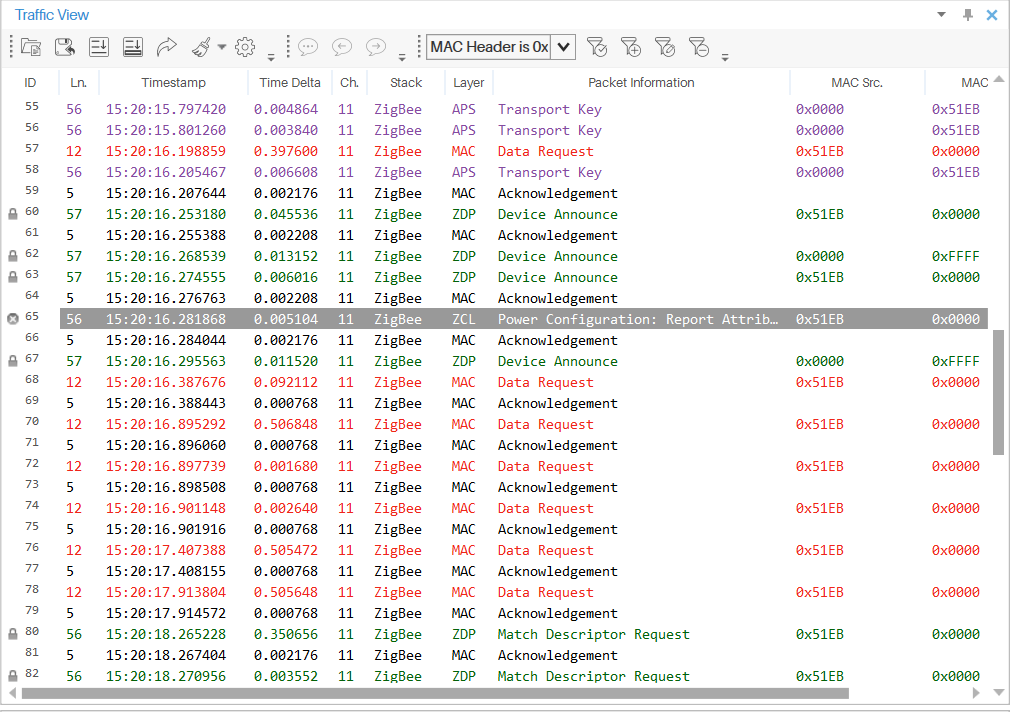

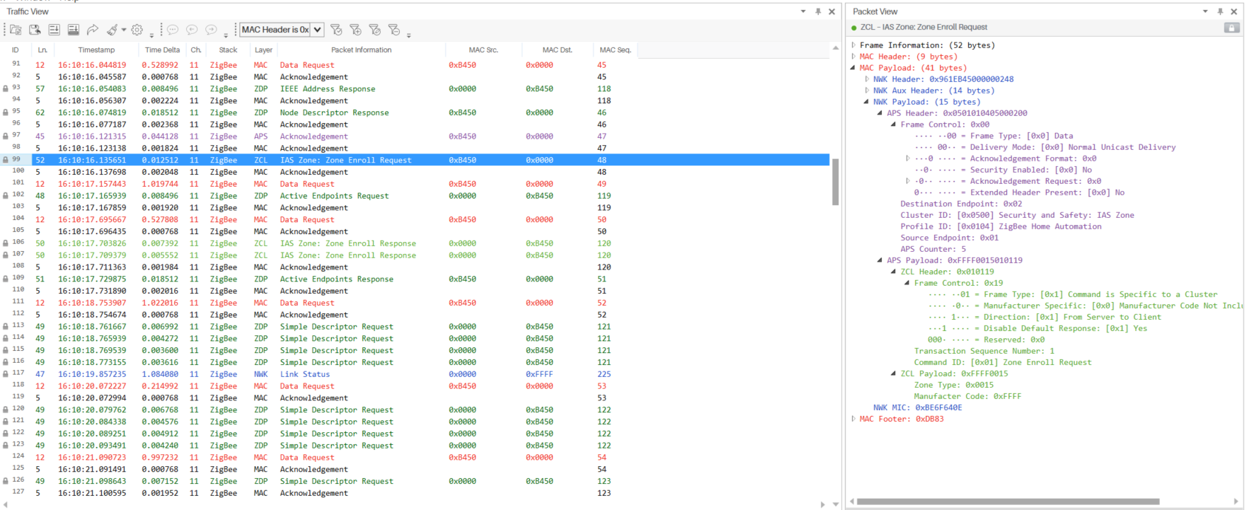

I am using z-stack 3.0.0 configure as coordinator device.
Coordinator not replay of IAS Enroll request, please let me know how to enable zone enroll response.
I have attached packet sniffer log file.enroll_response.zip

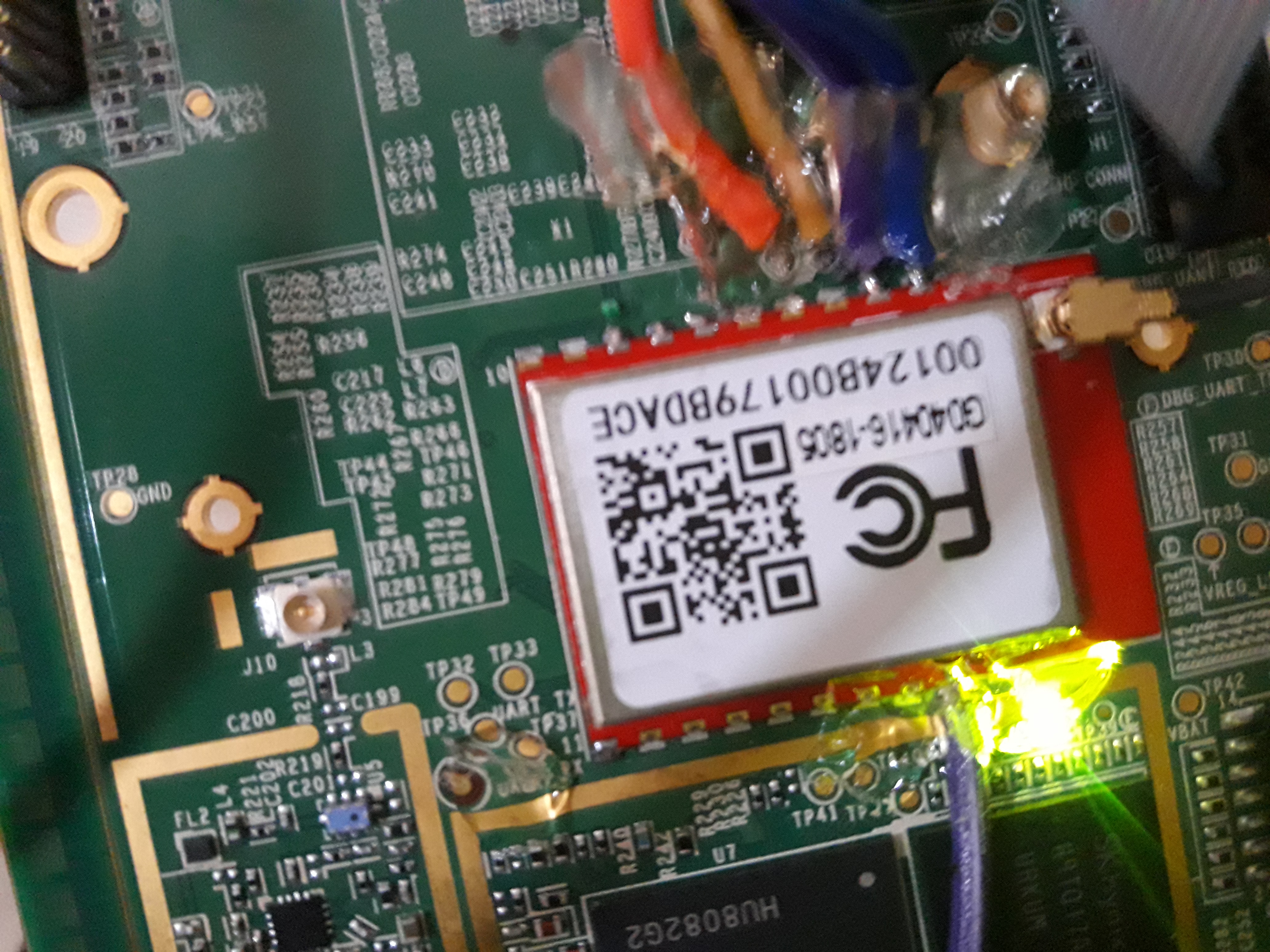

  • Can you take a picture to show me your HW connection?
  •  please find attached file.
  • I suppose this is the connection of i.Mx6 and CC2530. How do you connect CC2530 to desktop and communicate with ZTOOL? If you send SYS_PING command to your ZNP, does it ack?

    Recv  0xfd
    Yes, Using UART for Communication with ZNP , able to send/receive command, endpoint, cluster register process completed,  after send permit join command and command complete successfully execute, problem start from here, device start join process, transport key exchange  and device announce but did not receive device announce command, only receive 0xFD 0XFD value  same for other like match descriptor etc.
    Network communication data not send by firmware
    I have attached my log as well packet capture data.
    Uart log for device register information

  • We are using qualcomm boards and feibit module attached in board with p1.6/p1.7 , I can not use P0.2/P0.3, Please suggest changes for UART1.
    I have done following change for that.
    void InitBoard( uint8 level )
    if ( level == OB_COLD )
    // IAR does not zero-out this byte below the XSTACK.
    *(uint8 *)0x0 = 0;
    // Interrupts off
    osal_int_disable( INTS_ALL );
    // Check for Brown-Out reset
    ChkReset();
    #if defined CC2531ZNP
    znpCfg1 = ZNP_CFG1_UART;
    #elif defined CC2530_MK
    znpCfg1 = ZNP_CFG1_SPI;
    znpCfg0 = ZNP_CFG0_32K_OSC;
    #else
    znpCfg0 = ZNP_CFG0_32K_OSC ;
    //znpCfg1 = P2_0;
    //znpCfg0 = P1_2;
    // Tri-state the 2 CFG inputs after being read (see hal_board_cfg_xxx.h for CFG0.)
    //P1INP |= BV(2);
    P2INP |= BV(0);
    #endif
    else // !OB_COLD
    /* Initialize Key stuff */
    HalKeyConfig(HAL_KEY_INTERRUPT_DISABLE, OnBoard_KeyCallback);
    #define HAL_PA_LNA_CC2592
    #define HAL_UART_DMA 2
    #if (HAL_UART_DMA == 1)
    #else
    #define HAL_UART_PERCFG_BIT 0x02 // USART1 on P1, Alt-2; so set this bit.
    #define HAL_UART_Px_RTS 0x20 // Peripheral I/O Select for RTS.
    #define HAL_UART_Px_CTS 0x10 // Peripheral I/O Select for CTS.
    #define HAL_UART_Px_RX_TX 0xF0 // Peripheral I/O Select for Rx/Tx.
    #endif
    static void HalUARTInitDMA(void)
    halDMADesc_t *ch;
    P2DIR &= ~P2DIR_PRIPO;
    P2DIR |= HAL_UART_PRIPO;
    PERCFG &= ~HAL_UART_PERCFG_BIT; // Set UART0 I/O to Alt. 1 location on P0.
    #else
    PERCFG |= HAL_UART_PERCFG_BIT; // Set UART1 I/O to Alt. 2 location on P1.
    #endif
    PxSEL |= HAL_UART_Px_RX_TX; // Enable Tx and Rx on P1.
    // Configure relevant Port P0 pins back to GPIO function
    P0SEL &= ~0x3C;
    ADCCFG &= ~HAL_UART_Px_RX_TX; // Make sure ADC doesnt use this.
    UxCSR = CSR_MODE; // Mode is UART Mode.
    //UxUCR = UCR_FLUSH; // Flush it.
    UxUCR |= 0x00;
    Please let me know, what other change required?
  • I suppose you only need to define ZTOOL_P2 instead of ZTOOL_P1 in your project to make UART switch to p1.6/p1.7.
  • Thanks for replay,
                         I try ZTOOL_P2 option, but not working.
  • Try to trace and debug your ZNP to make sure it uses ZTOOL_P2. If i's possible, I would suggest you to use scope to check signal on p1.6/p1.7 too.
  • You also need to set HAL_UART_DMA to 2 inside of hal_board_cfg.h, as YK mentioned it would be great to debug the registers inside of IAR to make sure that at least the P1SEL, U1UCR, and U1CSR registers are set as expected.
    Ryan
  • Thanks for replay Rayan,
                                        I think U1CSR 7 bit become 0 (SPI mode) when send data.  if U1CSR 7 bit set  0 before send then host allows received oxFD value.
                                        I set U1CSR 7 bit value 1 before send data, but result getting same.
  • The U1CSR MSB is set by the user and it is not expected to change during operation. Bit 6 determines whether the UART received is disabled or enabled, bit 5 only concerns SPI, all other bits in this register are status indicators.
    Ryan
  • Make sure you don’t enable LCD driver.
  • Chen/Ryan thanks for replay,
                                   It's look like kernel side issue, I am cheeking, I will replay after debug.
  • Hi sanjay, has your issue been resolved?
    Ryan
  • Yes, issue in kernel side, zigbee working fine.
    Thanks for your support.

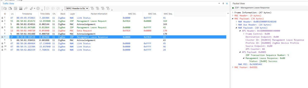

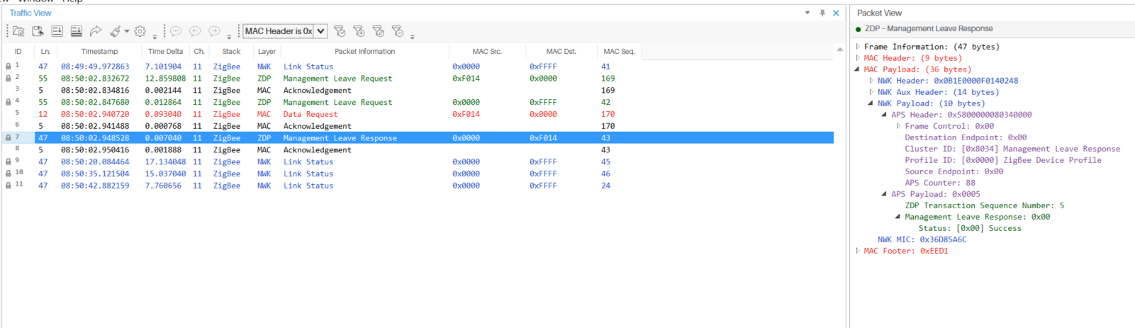

                    I am facing issue with zstack 3.0, Leave indication is not come in ZNP with z-stack 3.0,
                    Device send leave request and coordinator replay of leave notification,  but following function not call MT_ZdoLeaveInd to send device leave event.
                   in config following option set
                    /* MT_ZDO interface */
                   -DMT_ZDO_CB_FUNC
                    -DMT_ZDO_FUNC
                   -DMT_ZDO_MGMT
                    -DMT_ZDO_EXTENSIONS
                  and  allows enable ZDO_MGMT_LEAVE_REQUEST and ZDO_MGMT_LEAVE_RESPONSE in ZDConfig.h
                 Please check attached file.
  • Hi sanjay,
    You can debug to verify that the MT_ZDO_MGMT_LEAVE_REQ case of MT_ZdoCommandProcessing is entered, this results in a MT_ZdoMgmtLeaveRequest but there is no MT_ZdoLeaveInd in Z-Stack 3.0
    Ryan

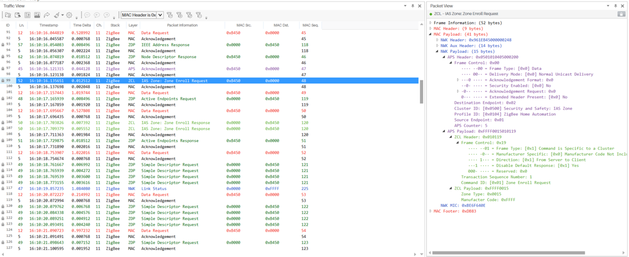

                    I am facing another issue with IAS Zone device, coordinator join with device, but end device not sending any alarm notification.
                   coordinator replay of Zone enroll request in join process.

  • Hi sanjay,
    Sniffer log files are more helpful than images. I notice that the ZED is not responding to any Simple Descriptor Requests but is still sending out Data Requests. Make sure you are pulling from the latest examples: git.ti.com/.../z-stack-example-apps
    Are you using a ZC CIE and ZR Fire Detector? Please note the relationship between the CIE and Fire Detector: "You can now send squawks from the CIE to the connected Warning Device with SW4 on the CIE, or you can cause a zone status change on the Fire Detector (i.e. start detecting a fire) by pressing SW4 on the Fire Detector, which will send a zone status change to the CIE and send an alarm to the Warning Device." processors.wiki.ti.com/.../Fire_Alarm_System
    Ryan
  • Hi Ryan,
        I am using context switch, I have two different vendor context switch, in one context switch sending door open or close notification.
       but another not sending notification. working context switch sniffer log will send tomorrow.
       Both working with CC2531 USB dongle.
       please find sniffer for not working.
     IAS_devices.zip
