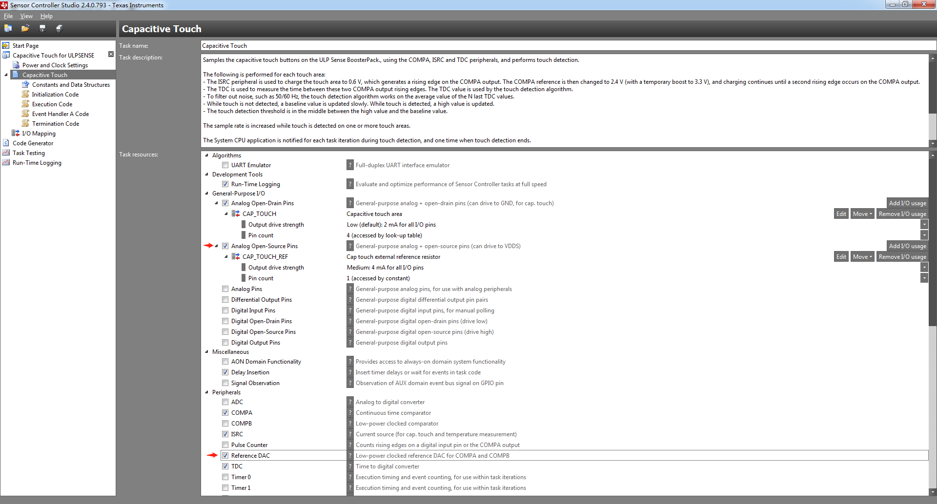

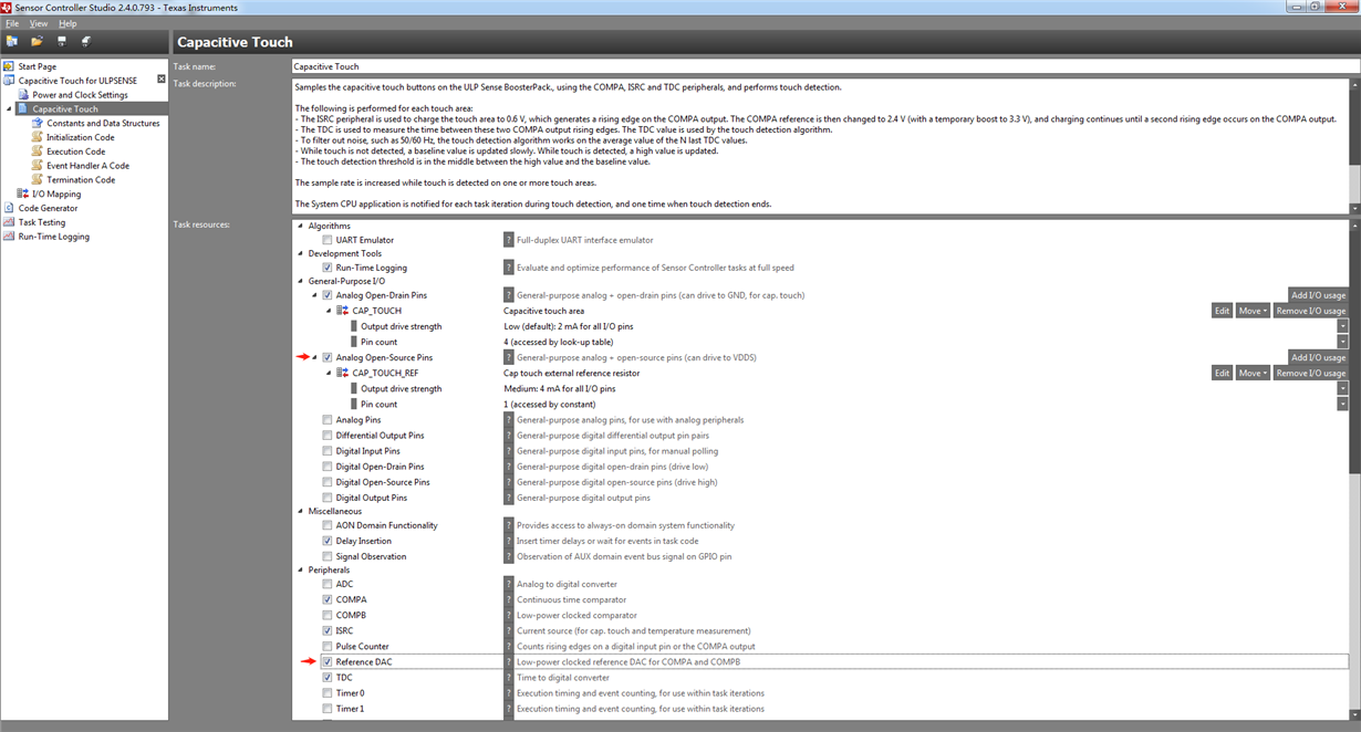

    Alternatively, you can use the internal DAC as reference instead of Rbias.
    -Simon
  • is it needed select cap touch external reference resister if use the internal DAC as reference? How to select options in Sensor Controller Studio?
  • With the DAC you don't need an external resistor. We have just started to play with this solution, so we don't have the same experience as with the Rbias solution.
    I have attached the Sensor Controller Studio project, so you can start playing with it and test if if works better for your application.
    -Simon
    https://e2e.ti.com/cfs-file/__key/communityserver-discussions-components-files/158/cap_5F00_touch_5F00_ulpsense_5F00_dac.scp

    The DAC example without external Rbias (1.2 Mohm) is work well in CC2652R Revision C platform,I have configure four cap touch buttons,but there are have a problem,
