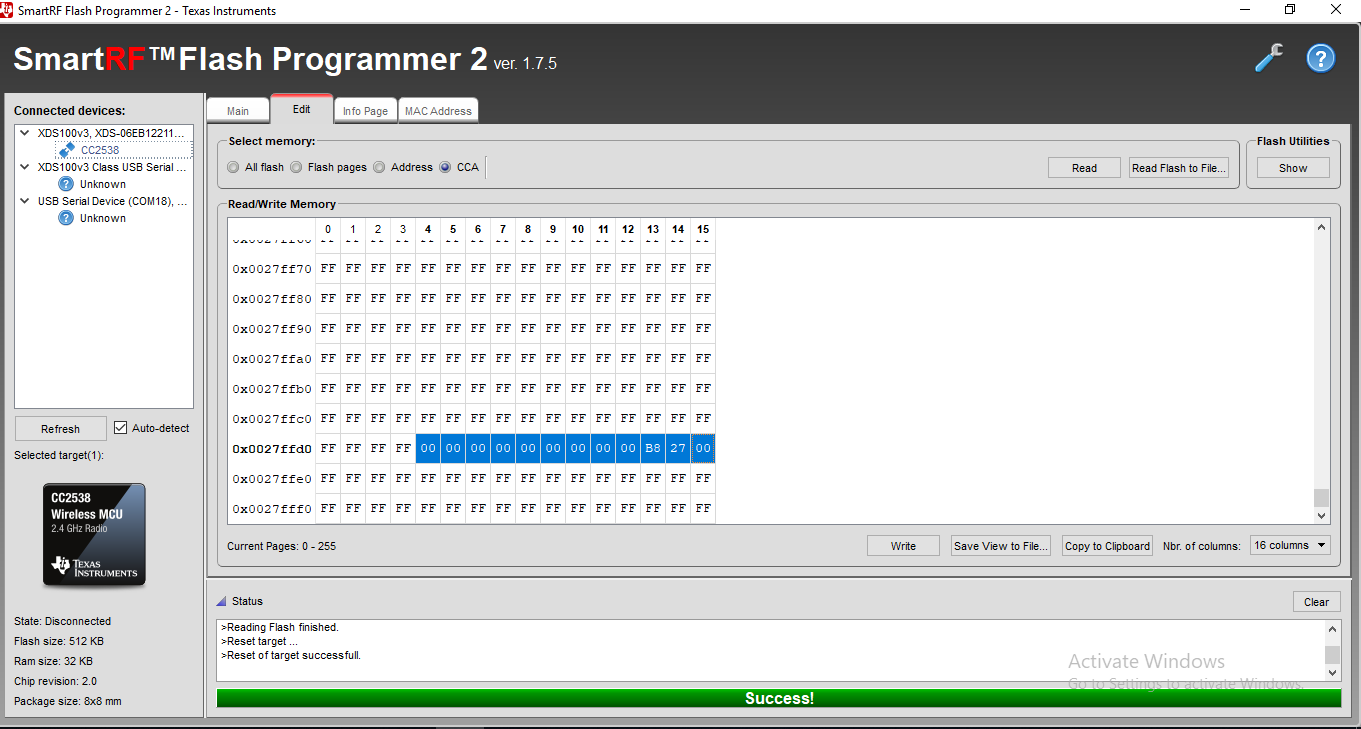

    I have gone through the CC2538-sb.icf & found the FLASH_CCA is defined here,
    // Define a region for Customer Configuration Area in flash.
    define region FLASH_CCA = mem:[from 0x0027FFD4 to 0x0027FFDF];
    also I have modified the BOOTLOADER_BACKDOOR_DISABLE value as follows.
    #define BOOTLOADER_BACKDOOR_DISABLE     0xF3FFFFFF

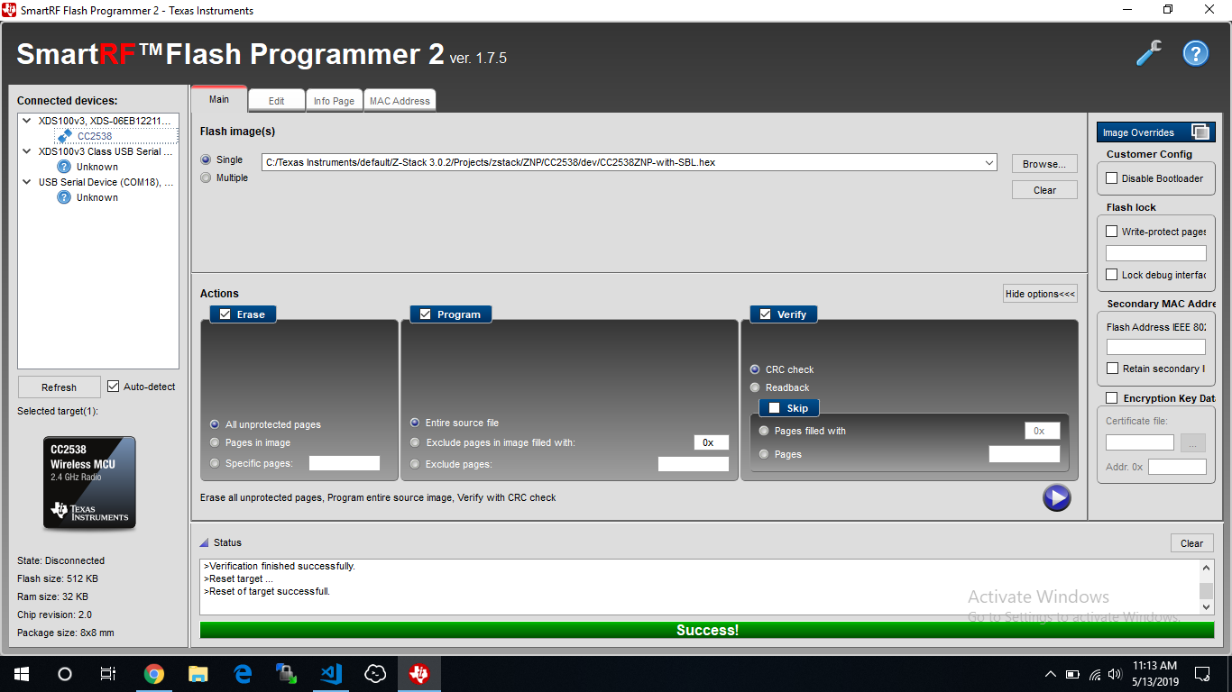

    I am using the Initial Image for the ZNP with SBL sample code of Z-stack 3.0.2
    & Zigbee Linux Gateway Application 3.0.1 Without any further Modifications.
    Initially,
    I have test the code by running ./zigbeeHAgw bbb script to test that my system is working with UART configurations.
    after that I reset both CC2538 ZNP device & BBB.
    pin PA3 connected to GND then I have started the sbl_tool.bin script using following command,
    ./sbl_tool.bin /home/debian/source/out/misc/CC2531-GW-ZNP_39203.bin /dev/ttyO4 1
    Still I am not able to use sbl_tool.bin to program the CC2538 ZNP device.

  • Yes,
    I am able to flash the code ( i.e. CC2538ZNP-with-SBL.hex file ) to ZNP Device. Using Flash Programmer.
    If I am trying to do with the sbl_too.bin. Its not Working.
    seen attachment given below will let you know that Flash programmer will able to communicate & programm the CC2538 Device.
    Shiv Patil.

  • Hello YK Chen,
    I have tried to read the FLASH_CCA Area for the CC2538 device & I found something different in it.
    FLASH_CCA  will be highlighted in the images.
    see the following attachments,
    When I erase the flash of CC2538 Device, FLASH_CCA  memory address are as follows.
    But when I flash the CC2538ZNP-with-SBL.hex to CC2538 Device.
    Now,
    we set the configurations for bootloader backdoor is as follows,
    #define FLASH_START_ADDR 0x0027B000 // page for Serial Bootloader.
    So,
    values @ 0x0027FFD7 address must be 0xF3FFFFF but its not seems like that.
    I am trying to trace the code but unable to find where those value are written to the flash.
    WIll you please help me to know that.
