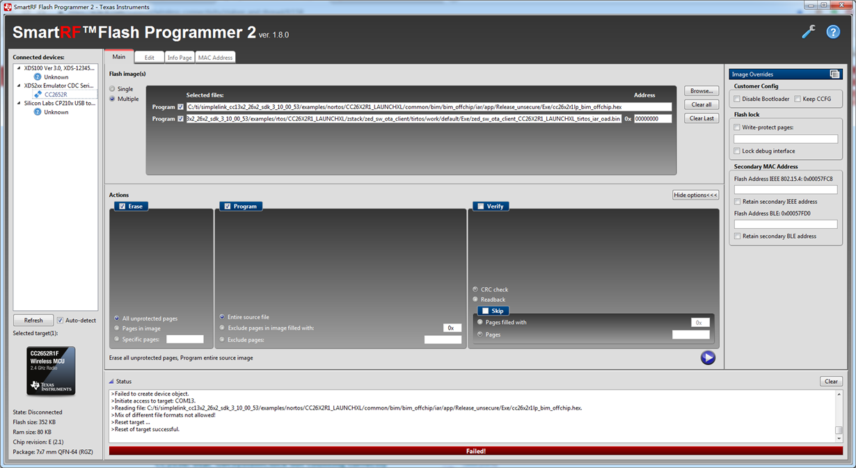

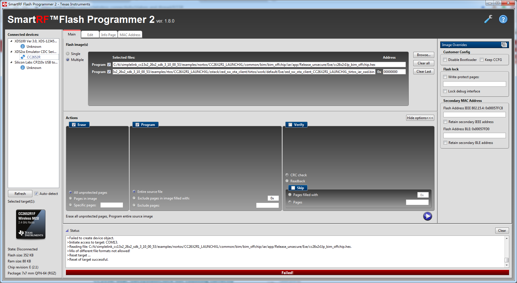

BTW,Why Flash Programmer 2 report Mix of different file formats not allowed!
Please refer to this post: https://e2e.ti.com/support/wireless-connectivity/bluetooth/f/538/t/810225?RTOS-LAUNCHXL-CC26X2R1-How-to-combine-BIM-image-and-application-image-
Also, if you are using IAR to build, you can right-click the project, then select Options -> Output Converter -> check Generate additional output -> select Intel Extended Hex. This will generate the hex file so you can flash two hex files with SmartRF Flash Programmer 2.
Toby
