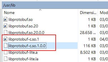

    Startup phase 1 completed successfully, server started (NPI_PID=10210) on Thu 4 Jul 10:09:46 CEST 2019
    starting ZLSZNP, cmd ' ./ZLSZNP_arm 127.0.0.1:2533 config.ini -v 0x0000460E ' on Thu 4 Jul 10:09:46 CEST 2019
    ./ZLSZNP_arm: error while loading shared libraries: libprotobuf-c.so.0: cannot open shared object file: No such file or directory
    Startup phase 2 failed
    Inside the /usr/lib the lib file is till present:
    To be sure about library path the file /etc/ld.so.conf.d/libc.conf was edited as below (added the /usr/lib path):
    # libc default configuration
    /usr/local/lib
    /usr/lib
    may be this issue related the release version of the libprotobuf-c.so.0 that in my version is instead libprotobuf-c.so.1 ?
    Actually the protobuf-c-compiler installed release was the following one:
    root@raspberrypi:/home/source/Projects/node# dpkg -s protobuf-c-compiler
    Package: protobuf-c-compiler
    Status: install ok installed
    Priority: optional
    Section: devel
    Installed-Size: 189
    Maintainer: Robert Edmonds <edmonds@debian.org>
    Architecture: armhf
    Multi-Arch: foreign
    Source: protobuf-c
    Version: 1.2.1-2
    Depends: libc6 (>= 2.4), libgcc1 (>= 1:3.5), libprotobuf10, libprotoc10, libstdc++6 (>= 5.2)
    Description: Protocol Buffers C compiler (protobuf-c)
     Protocol Buffers are a flexible, efficient, automated mechanism for
     serializing structured data - similar to XML, but smaller, faster, and
     simpler. You define how you want your data to be structured once, then you can
     use special generated source code to easily write and read your structured
     data to and from a variety of data streams and using a variety of languages.
     You can even update your data structure without breaking deployed programs
     that are compiled against the "old" format.
     This is the "protobuf-c" implementation of Protocol Buffers in C.
     This package contains the "protoc-c" code generator that creates C stubs from
     Protocol Buffers .proto files. These stubs must be compiled and linked against
     the libprotobuf-c support library.
    Homepage: https://github.com/protobuf-c/protobuf-c
    Thank.
