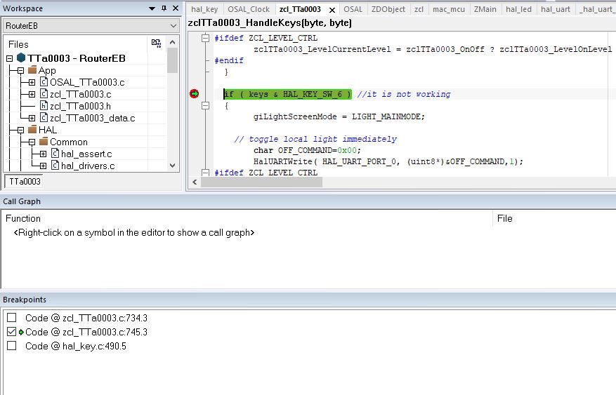

    zcl_TTa0003.c (my program)
    static void zclTTa0003_HandleKeys( byte shift, byte keys )
      if ( keys & HAL_KEY_SW_1 ) // it is working well when P2 Joystick (UP/DOWN/RIGHT/LEFT/CENTER) is activated
        giLightScreenMode = LIGHT_MAINMODE;
        // toggle local light immediately
        zclTTa0003_OnOff = zclTTa0003_OnOff ? LIGHT_OFF : LIGHT_ON;
    #ifdef ZCL_LEVEL_CTRL
    	zclTTa0003_LevelCurrentLevel = zclTTa0003_OnOff ? zclTTa0003_LevelOnLevel : ATTR_LEVEL_MIN_LEVEL;
    #endif
      if ( keys & HAL_KEY_SW_6 ) //it is not working.
    	char OFF_COMMAND=0x00;
    	HalUARTWrite( HAL_UART_PORT_0, (uint8*)&OFF_COMMAND,1);
    #endif
    Would you help me to fix button 1 / HAL_KEY_SW_6 it?

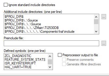

  • Do you define ISR_KEYINTERRUPT in your project predefined symbols to enable key interrupt?

  • Hi Mr. Yikai,
    Yes, I did it before, as you can see below:
    I did not express myself well, when I open posted here, this is happening intermittently. when I pressed S1 always the HAL_ISR_FUNCTION is hit, but the ( keys & HAL_KEY_SW_6 ) does not always occur. I get to press 20 times in a row and it doesn't work, sometimes right away. As you can see in the PIC bellow:
    Interestingly, the joystick (Port P2) always hits ( keys & HAL_KEY_SW_6) and then ( keys & HAL_KEY_SW_1 ) simultaneous.
    when it should reach only the ( keys & HAL_KEY_SW_1 ), in my opnioun.
    Mr. Yikai, do you help me to fix it?

  • Does HAL_ISR_FUNCTION hit every time?
  • Mr Yikai,
    Yes, the  HAL_ISR_FUNCTION hit every time!  But zclTTa0003_HandleKeys not!
    BR,
    Alex
  • Mr Yikai,
    stranger still it that  zclTTa0003_HandleKeys (keys & HAL_KEY_SW_6 ) hit every time when pressed any of the buttons on the joystick, even though the Joistick works with P2 port and the respective interrupt (HAL_ISR_FUNCTION( halKeyPort2Isr, P2INT_VECTOR ).
    Note: I commented on all the entries has LED_4 and LED_1 in the code zcl_TTa0003.c, and nothing changed!

  • When you try to check if it hits breakpoint on "zclTTa0003_HandleKeys", do you disable breakpoint on "HAL_ISR_FUNCTION( halKeyPort0Isr, P0INT_VECTOR )" first?
  • Yes, I have check those functions in the different moments!
    I'll let you know tomorrow about  the test in USB Dongle w/ CC2531!

    Note: I have included also ISR interrupt to enable interrupts on IAR Compiler-> Preprocessor-> DefinedSymbols.
