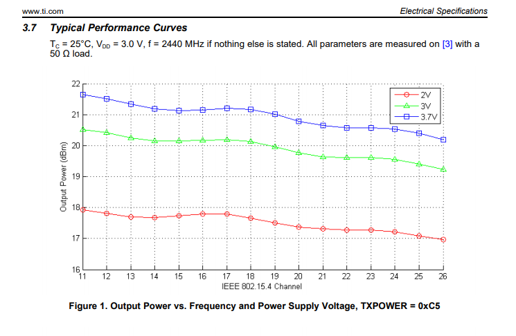

Hello all,
what is the minimum supply voltage required for 22dbm TX power when cc2538-cc2592emk is powered by USB mode.
what can happen if the supply voltage is below minimum level?
