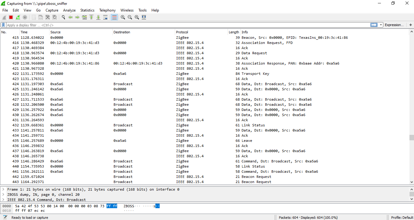

Hello Community,
I am working on the CC2538 ZNP device & the znp host framework application.
When I am sending a permit joining request to the device,
the device is sending the MT_ZDO_TC_DEVICE_IND instead of the MT_ZDO_END_DEVICE_ANNCE_IND.
Will you please help me to know,
what is use case of the MT_ZDO_TC_DEVICE_IND  & when it is occures ?
How do I handle this response while adding devices to the network ?
How do I get the MT_ZDO_END_DEVICE_ANNCE_IND from the device while joining it in to the network ?

  • Hello Shiv,
    The MT_ZDO_TC_DEVICE_IND response indication message occurs on a ZC device and is sent from the Z-Stack Thread whenever the Trust Center allows a device to join the network.  The MT_ZDO_END_DEVICE_ANNCE_IND should follow shortly once the ZED has been properly initialized inside the network and sets its device state accordingly.  Please provide a sniffer log of the failed joining if you would like more assistance in debugging this issue.  If you are attempting to join a 3.0 device to a 1.2.2a HA network then this will fail if the 3.0 device is expecting a Link Key update: http://www.ti.com/lit/swra615

  • Hello ,
    First of all I would like to know,
    I am using CC2538 device as a znp & end device, the ZNP HOST FRAMEWORK Application as a host.
    How I am able to know which network I am working on 3.0 OR 1.2.2a HA network?...
    Also
    I am also need to know that if the MT_ZDO_TC_DEVICE_IND received from the end device should I need to process it?
    OR send some request/response to end device after this received indication (the device which is getting added to the network).
    becouse I am not able to add the device in to network becouse of this. I am sending you the znp host framework & sniffer logs to understand the problem.

  • Hi Shiv,
    There are no clues provided during device joining to help you determine what specification of Zigbee network you are connecting to, it is only afterwards that you can figure this out through the network behavior.  For example, the sniffer log screen shot indicates that the ZC has formed a 3.0 network for which a TC Link Key update is expected and therefore asks the ZED to leave after it does not initiate this process.  In Z-Stack 3.0 this is controlled by the BDB_DEFAULT_TC_REQUIRE_KEY_EXCHANGE and BDB_DEFAULT_TC_NODE_JOIN_TIMEOUT in bdb_interface.h.  MT_ZDO_TC_DEVICE_IND should not be processed by ZR/ZED nodes.
