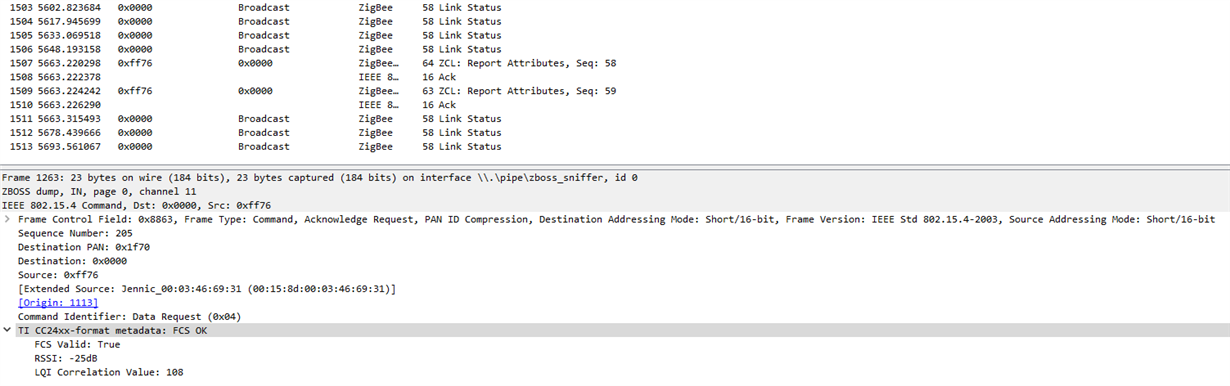

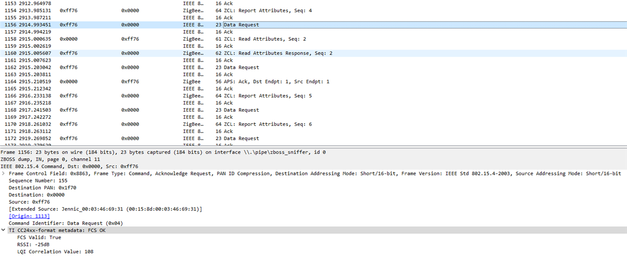

  • When the sensor joins the network, the log looks like this:
    And you can even see my "Read Attributes" and the "Read Attributes Response". However I do not understand what is for the "Data Request" from the sensor at this point?
    Later, when the sensor is not answering my Read Attributes commands anymore (they do not even get to the air because my coordinator doesn't send them) the sniffer looks like this:
    Those Report Attributes are because I moved in front of the sensor. There is no sign of any data request here, not even from me or the sensor.
    Thanks for any further guide.
    Regards!
  • During joining the ZED could be sending Data Requests until the F&B/permit join time expires or it is sure that commissioning has been completed.
    You will notice that before/after sending the Report Attributes, the ZED does not send any data requests to ask for information queued by the ZC.  This is something that should be modified by your ZED's application.
