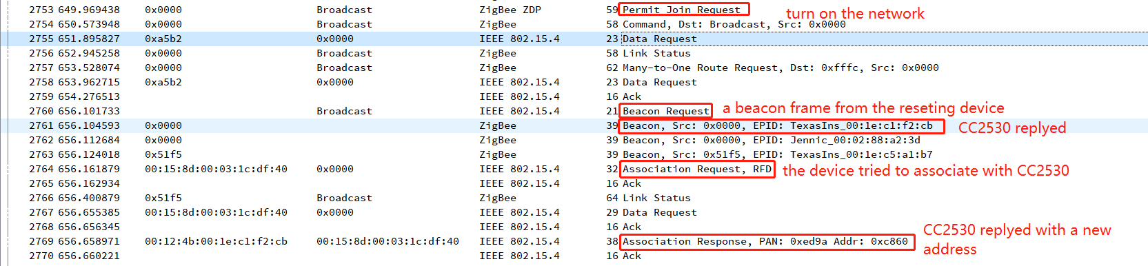

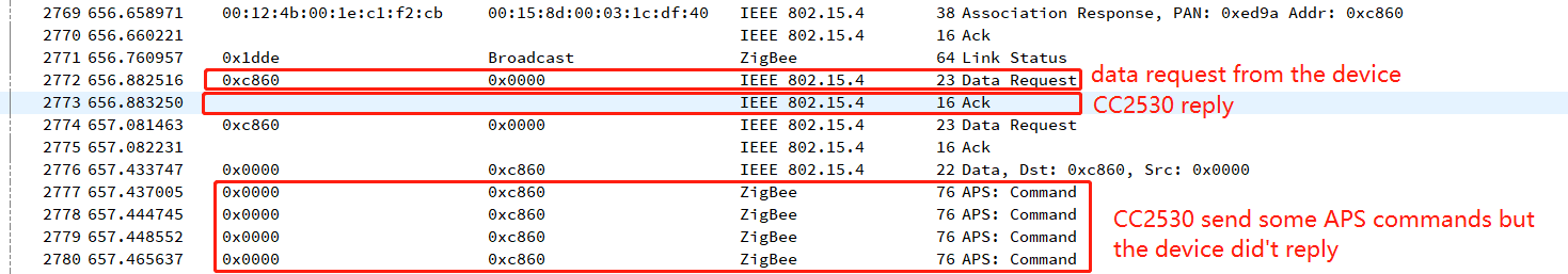

I found a weird issue about the CC2530 that it fails to pair a new device after a period of time.
The firmware I use is from https://github.com/Koenkk/Z-Stack-firmware/tree/master/coordinator/Z-Stack_Home_1.2/bin/default
I turned on the sniffer and catched some packets, here is what I found:
Here is the full log https://github.com/4djason/Z-Stack-firmware/blob/master/log/fail_to_pair.pcapng
please follow these steps https://github.com/4djason/Z-Stack-firmware/tree/master/log to view the encrypted pard.
I can't figure out why the new device did nothing after the assocation. Can anyboby tell me why?
