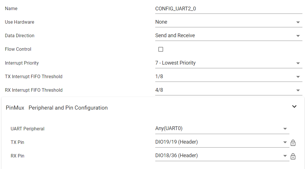

  • Ryan, here is more info.
    Previously I was using SDK 3.20.0.68. At that time I configured the second UART with RX=DIO18 and TX=DIO19. This was before SysConfig, so I configured the second UART by adding RX and TX entries in BoardGpioInitTable[] .  This worked without problems.
    A couple of days ago I upgraded to SDK 4.10.0.78. This SDK has SysConfig so I don't need to directly edit tables anymore. I used SysConfig to configure the second UART with RX=DIO17 and TX=DIO16, as I described in my original post. But it doesn't work.
    Since I had the second UART working with before the upgrade, I decided to go back to using the pins I used then. So using SysConfig I configured the second UART to use RX=DIO18 and TX=DIO19. But using these pins don't work either.
    Are you aware of problems with SysConfig? Before the upgrade, when I edited BoardGpioInitTable[] directly, these pins worked just fine with the second UART.

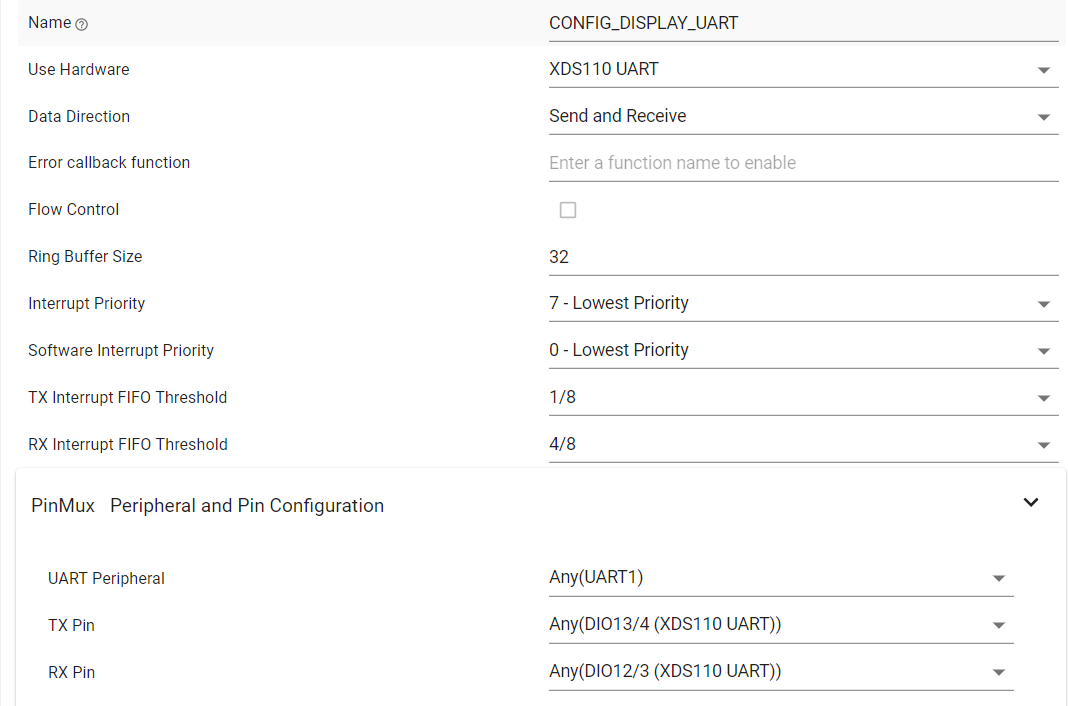

    In SysConfig I see this:
    UART was already enabled and it's configured like this (these are the default settings, I didn't change anything):
    UART2 was there but was disabled, so I added it using the + sign, and configured like this:
    So did I configure incorrectly?
    "Use Hardware" is None. The only other choice is XDS100 UART. I don't think I want that since I'm not using this port with the debugger.
    "UART Peripheral" defaulted to Any(UART0). The only other choice is Any(UART1), but that's already used by the first UART so I don't think I want that.
    I selected TX = DIO19 and RX = DIO18,

  • Ryan I solved this.
    In SysConfig, UART2 is NOT the second UART as I thought. I think UART2 is intended for use with the UART2 driver (not the UART driver).
    The solution for me was to remove my configuration from the UART2 section and instead add a second UART to the UART section of SysConfig and configure it to use DIO16 and DIO17 pins. I also tried DIO18 and DIO19 and they worked too.
    Note to other readers of this post: to use DIO16 and DIO17 pins you have to remove the TDO and TDI jumpers and configure your target configuration file (ccxml) for cJTAG 2-pin debug. My Launchpad came without these jumpers and my ccxml was already configured for 2-pin debug. You don't have to remove any resistors from the board.
