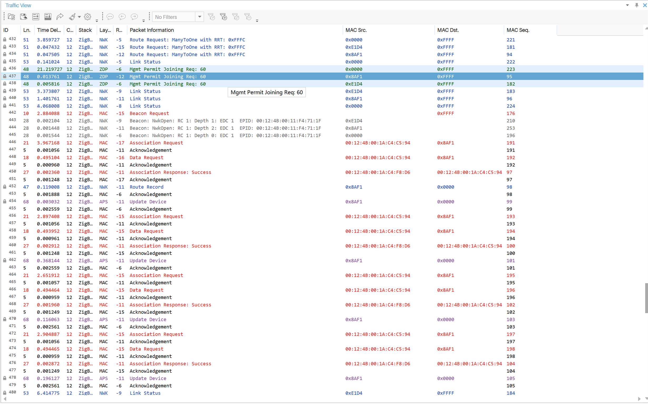

As we all known,some customer want to zigbee HA 1.2 devices join in standard zigbee 3.0 network formed by ZC,but the zigbee 1.2 and 3.0 not fully compatibility on ZC side,therefore,customer have to define macro TP2_LEGACY_ZC whenever build ZC project,but this may be caused a typical behaviour(the devices could not join network forever,seems like ZC don't process "Update Device" correctly),I have been resolved this issue recently,the following segments was my workaround.

    May be Ryan could confirm this workaround working well or not,of course, you can replicate this issue by yourself,reference  previous mentioned topic,only need three or four ZR,join the first ZR to ZC directly and successful,then join the second ZR through the first ZR,Update Device and Transport Key work well,and join another ZR one by one,you must be found third and other ZR could not indirect join in ZC forever.
    According the brief of bdb_TCAddJoiningDevice,this function is responsable track the "Request Key" issue or not whenever standard zigbee 3.0 devices join the network,but,zigbee HA 1.2 don't issue "Request Key" whenever join network,so ZC don't care key exchange procedure,only free the bdb_joiningDeviceList linklist whenever timeout (NodeJoinTimeout variable equal zero).

    Based on the logs, seems the issue is that ZC does not send Transport Key after receiving Update Device. But in cases of both indirect join (Update Device) and direct join, the Transport Key should happen before bdb_TCProcessJoiningList.
  • Yes,bug only influence indirect join network formed by zigbee 3.0 ZC,first indirect ZR(for example, ZR2 indirect join through ZR1) work well,but ZR3 and ZR4,... could not join network forever.
