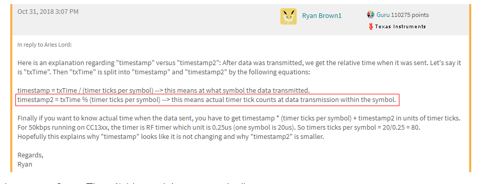

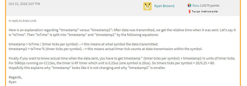

in ApiMac_mcpsDataCnf_t, there is timestamp and timestamp2. I use equations below in https://e2e.ti.com/support/wireless-connectivity/zigbee-and-thread/f/158/t/736993

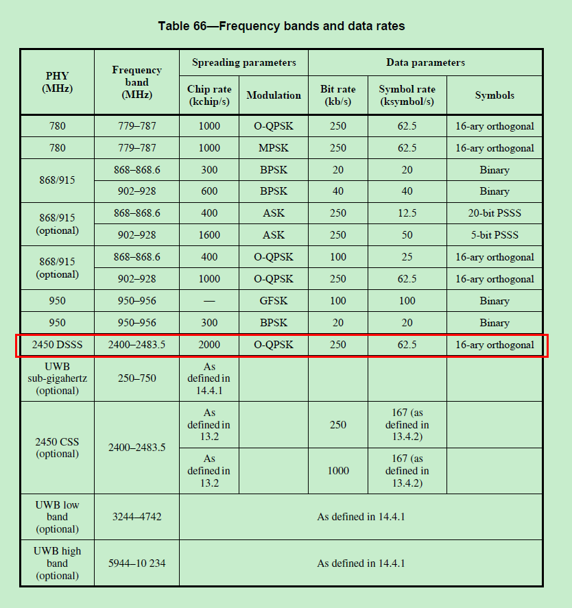

For 2.4G application, one symbol is 16us, RF timer unit is 0.25us, so, timer ticks per symbol is 16/0.25=64.
So, txTime = timestamp * 64 + timestamp2. This txTime should be the actual time when the data sent.
