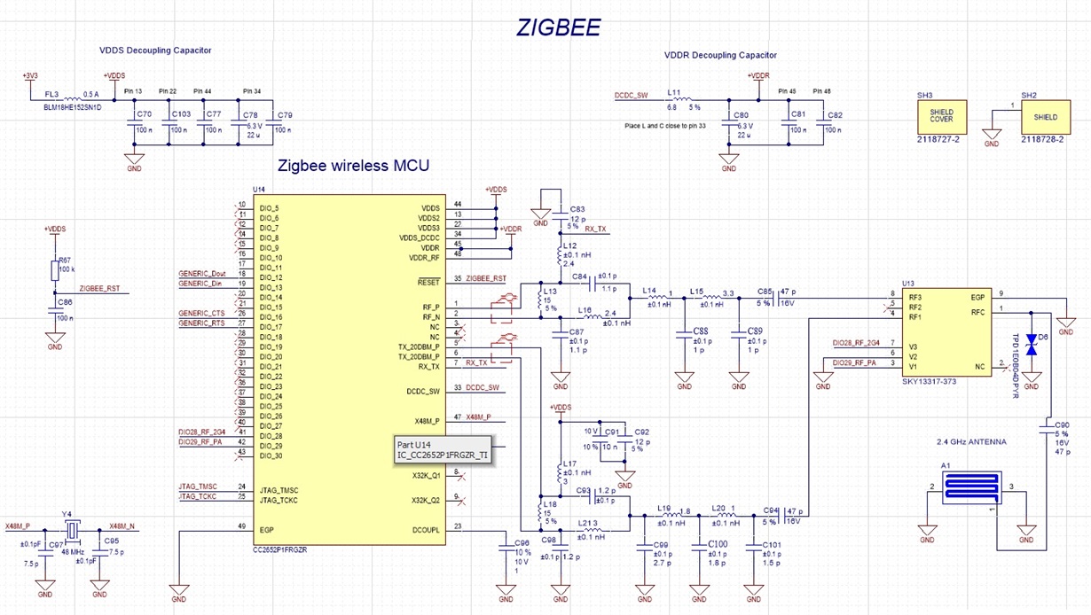

  • Hi Nathan,
    Thanks for your answer. I want to add info that we are getting from the test that we are running. We disable the Internal DCDC by hardware or firmware and the overconsumption disappear.
    Firmware
    Hardware
    Removing L11

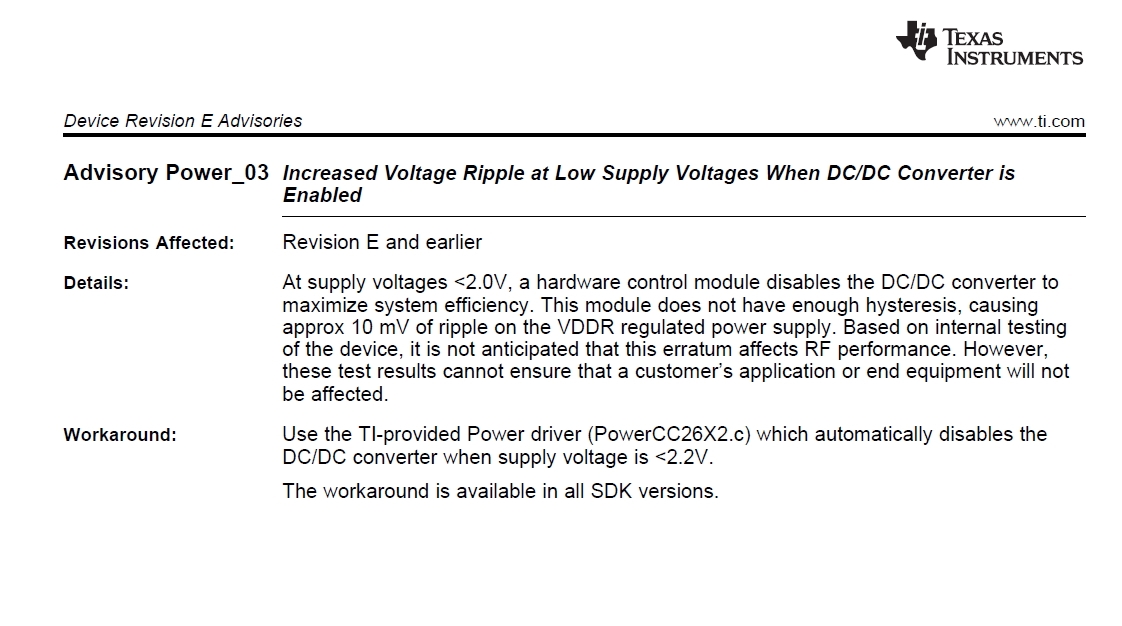

  • Hi Nathan,
    I Notice on the CC2652P errata document that there is some issue with the DCDC converter.
    This behaviour isn't the problem that we are having, just caught my attention, because it is the same module that we are having problems with.
    BR,
    Mauro
  • Hi Mauro,
    Thank you for submitting the materials. I plan on reviewing them in greater detail this week, one thing that did catch my eye early on was that the inductor listed in the BOM you've connected to the DCDC converter is 6.8 nH, whereas the value we specify in the design guide (page 11) is 6.8 uH. While I don't yet have an explanation for why this is only a problem for the 10-15% of your devices, I do wonder what would happen if you changed it to the 6.8 uH value in the spec. Could you take a faulty board and try changing out the inductor for a larger one? I'm not sure if this would completely solve your issue, but I think it's worth investigating.
    Nate
  • Hi Nathan,
    Yesterday I make the replacement of the inductor on two troubled boards, and the overconsumption dissapear. Apparently the wrong inductor, causes a malfunction of the internal DCDC converter of the CC2652P generating an over consumption.
