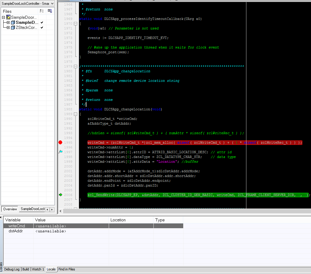

    As I post debug image yesterday, before call zcl_SendWrite function, writeCmd variable value is abnormal.
    what is yr opinion?
  • What do you mean "writeCmd variable value is abnormal?"
  • Hi YiKai
    In DLCSApp_changeLocation function call, I used zclWriteCmd_t *writeCmd to assign command data. (refer above src code)
    finally assign the write command I call zcl_SendWrite function to write command over the air to server side.
    With debugging mode, I checked writeCmd variable in Local tab, find that there is no value assign in it.
  • That is because IAR cannot watch local variable. You can declare it as static like "static zclWriteCmd_t *writeCmd;" and you can watch it.

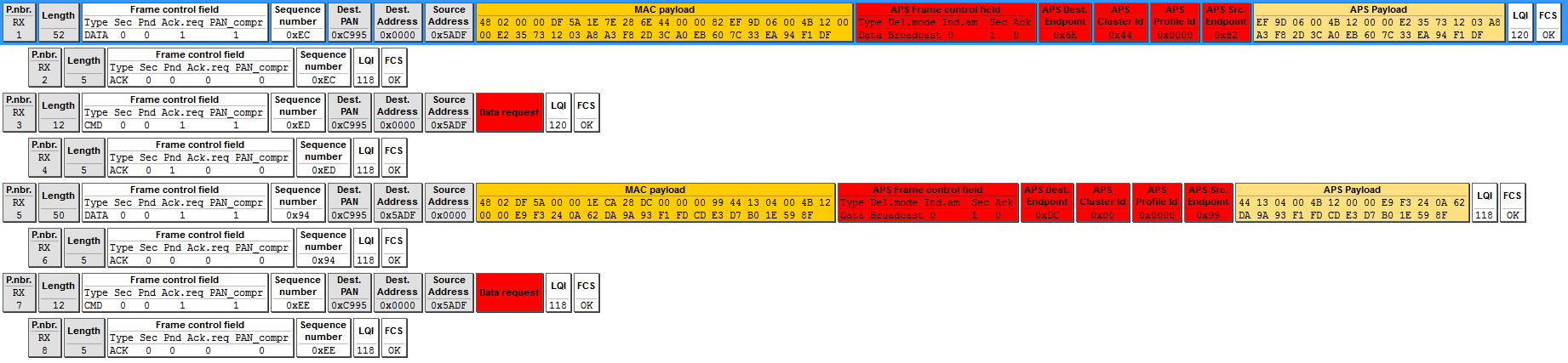

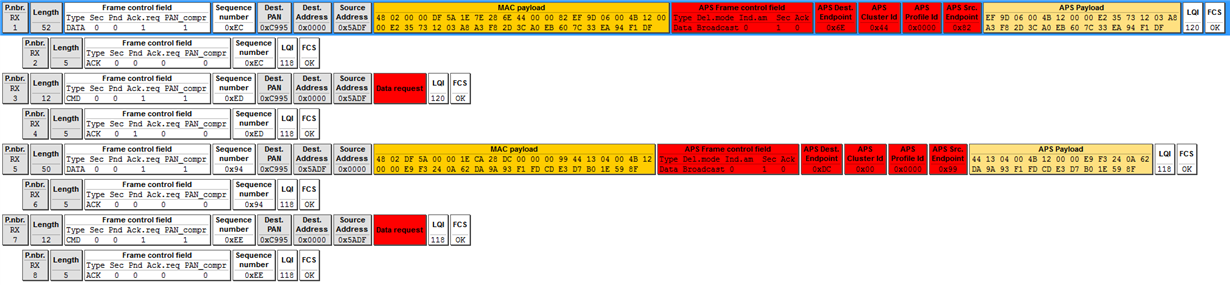

  • Hi YiKai
    Please see below picture, what is captured by packet sniffer.
    when I trigger send write attribute command, there is nothing special packet over the air.
    ==================================== send write attribute command =============================================
    ===================================== send change light level control command ======================================
    If I send change light level command, sniffer packet shown as below picture.
  • Try to check return status of zcl_SendWrite first.

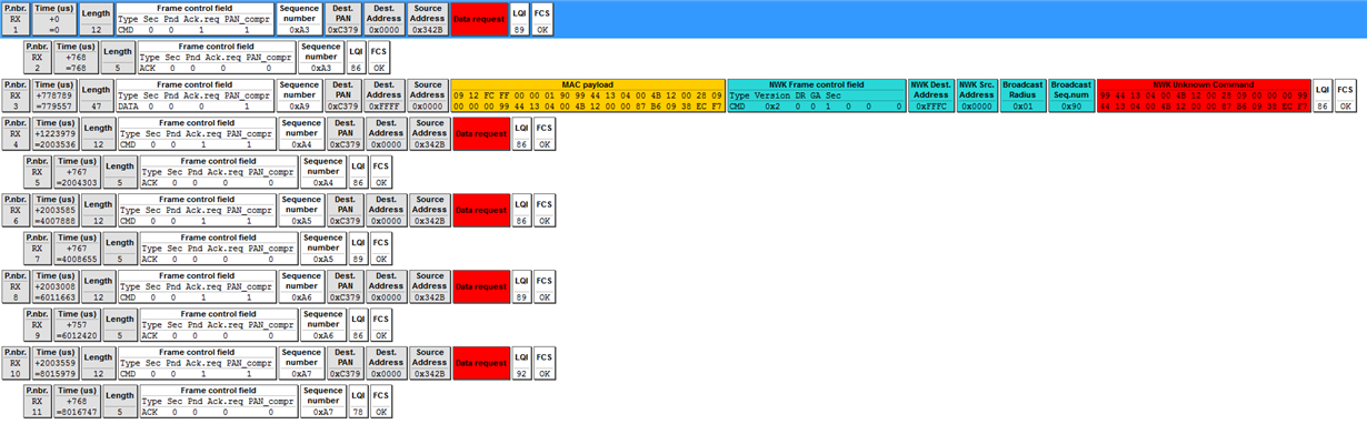

  • Hi Yikai,
    See below picture what is captured at time of send attribute cmd.
    Seems that no relative packet send out by Switch side.
  • Can you attach sniffer log file not a screen shot only?
  • Hi, YiKai
    Please refer attached psd file
    Thankspacket.psd
  • Yes, there is nothing sent in your sniffer log. Since your destination is coordinator, I would suggest you to use short address to send and see if it works.

    When I send command, I can captured some packet as attached. seems that something send out from switch side.
    If it is relative command to light, at light side where should I set break point to check receiving message ?
    location_cap.psd
  • I see the write attribute command is sent in the attached sniffer log. You can try to set a breakpoint in zclProcessInWriteCmd to check receiving it.

           does   below  code  not work?
    static void DLCSApp_changeLocation(void)
    	afAddrType_t dstAddr;
            uint8 Location_buf[] = { 8, 'L','o','c','a','t','i','o','n' };
      	writeCmd = (zclWriteCmd_t *)zcl_mem_alloc( sizeof( zclWriteCmd_t ) + ( 1 * sizeof( zclWriteRec_t ) ) );
    	writeCmd->numAttr = 1;
    	writeCmd->attrList[0].attrID = ATTRID_BASIC_LOCATION_DESC; // attr id
    	writeCmd->attrList[0].dataType = ZCL_DATATYPE_CHAR_STR;	   // data type
    	writeCmd->attrList[0].attrData = Location_buf; //buffer
    	dstAddr.addrMode = (afAddrMode_t)zdlcDstAddr.addrMode;
            dstAddr.addr.shortAddr = zdlcDstAddr.addr.shortAddr;
            dstAddr.endPoint = zdlcDstAddr.endpoint;
            dstAddr.panId = zdlcDstAddr.panID;
    	zcl_SendWrite(DLCSAPP_EP, &dstAddr, ZCL_CLUSTER_ID_GEN_BASIC, writeCmd, ZCL_FRAME_CLIENT_SERVER_DIR, 0, 0);
  • Your code looks fine so I suspect the problem is destination address.
