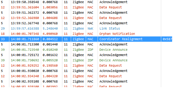

Captured files as below, seq 401. Seems it comes from nowhere. In what situation the Coordinator Realignment will happen? What it does?

I found out the reason, the ZED was reset by other IC on PCB, and when it rejoin the network, it first send out an orphan notification. Then the ZC reply with a Coordinator Realignment.
