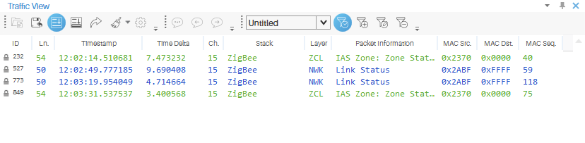

    here is sniffer test and analyse from my colleague Davide:
    - test: send on/off every 1/2/5 seconds to lamp and plug, alternatively or together
    - result: sometimes we experience unexpected wait time between "command ok" from SPI of cc2538 and activation/deactivation of lamp/plug
    I sniffed zigbee protocol on air to check what happens and the result is:
    1) the delay is due to cc2538 not sending the command frame on air (sometimes I have seen 10s+ delays)
    2) any incoming frame seems to unlock this situation almost immediately.
    I see this happening 100% of the times with for example broadcast link status frame from device and ias zone device
    check the images, if this "sleep" time occurred, these incoming frame unlocked situation and cc2538 starts to send the commands in air again

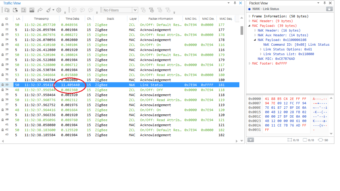

  • According to your sniffer screen shot, your coordinator keeps sending command in several milliseconds interval and that's cause the problem.
  • yes, indeed our zigbee chip sends out 2 commands in 100ms for on and off, one to switch on/off and one to request status
    we want to know which is the property timeout between two commands we send out?
    and why when the cc2538 receives link status frame and starts to send frames again?
  • lots of your commands are sent within 20 ms and this is too fast. I would suggest not to send command with interval less than 100 ms.
  • as you can see from the picture, after the frame 33, the one that wakes up after 11s the cc2538. the frame are sent fast by the cc2538 ittself as they are inside his message queue.
    we don't send from our code frames with < 100ms timeout in this test
  • If you have a look on packets before no.33, the interval is still very small.
