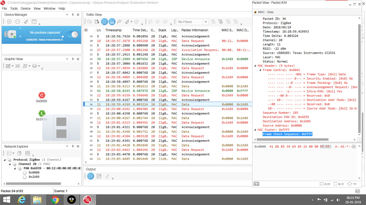

I am running the Z-Stack Mesh 1.0.0 configured as End-Device on CC2531. On the other CC2531 device, I have a Zigbee Co-Ordinator. Post Association Request - Association Response and Device Announcement, the End-Device would keep consistently polling the parent for any data available through the Data Request.
I am observing some Data Packets being sent by MAC Layer (TI-MAC) of the Co-Ordinator, which automatically stops after a few data requests from the end-device. Please find attached the Sniffer Logs. Is this expected behavior?

  • Hello Abhay,
    There are cases where empty data packets are intentionally sent, for example when there are too many ZEDs in the MAC source matching table. If there isn't any space then you just set the pending bit for all MAC Data Requests to frame pending temporarily as a work around until the buffers are cleared to guarantee that devices can receive their messages before they expire. The relevant define is MAC_SRCMATCH_SHORT_MAX_NUM_ENTRIES. So although not typical it is possible for data packets of zero length to exist, however generally expected behavior is that the data requests are acknowledged but not replied to as shown later in your log.

  • Hello Ryan,
    In my network, I have only one End-Device trying to connect to the Co-Ordinator. The MAC_SRCMATCH_SHORT_MAX_NUM_ENTRIES is set to 24. Under high traffic conditions, we might expect this behavior. But with the current setup, do you see any other reason why this behavior is observed?
  • I only mentioned source matching as an example, not a suggestion as to what the issue was. Are you using TI examples or a custom application? I wouldn't be concerned with short-term behavior, does it always disappear after a few seconds?

  • Yes Ryan,
    It does always disappear after a few seconds. At times, there are no empty data packets exchanged as well. I am running the sample application (GenericApp) from Z-Stack Mesh 1.0.0.

  • This was caused due to the mismatch in the PAN ID when putting the data in the pending queue meant for the associated end-device (Address Is Good, PAN ID Is Wrong). A fix to that eliminated this issue.
