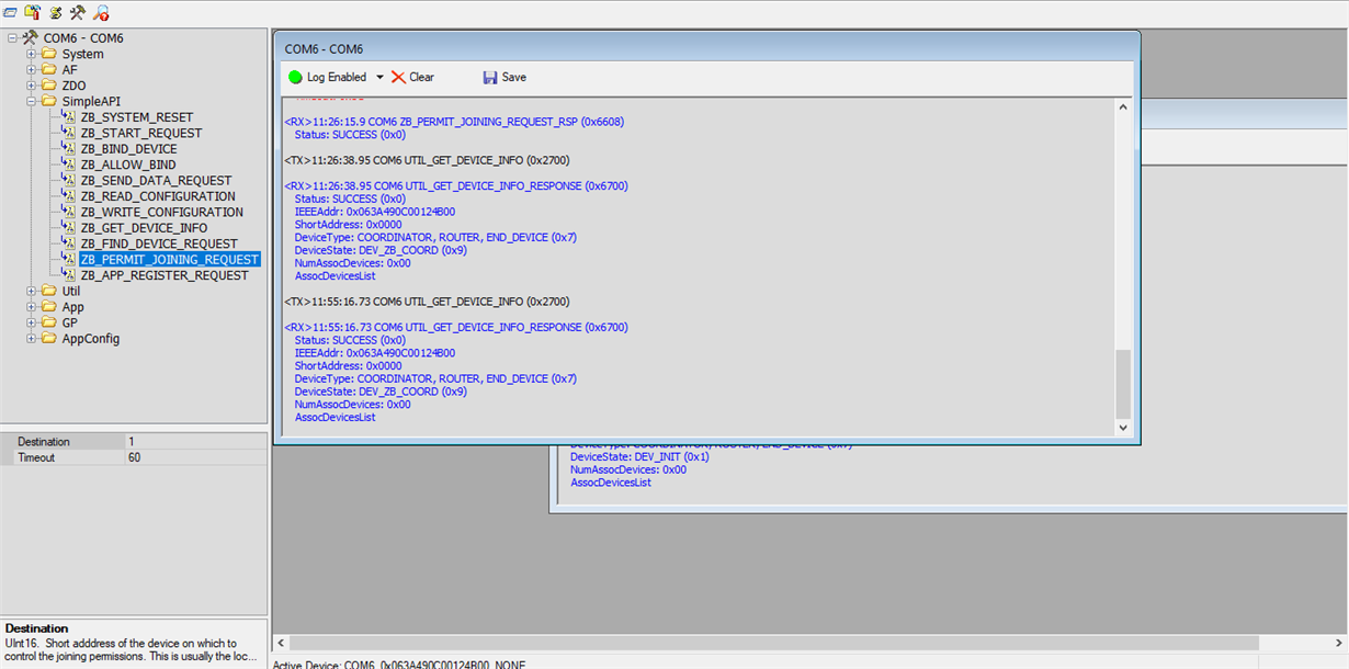

  • You have to enable permit join on coordinator to allow end device to join and DeviceState will turn to END_DEVICE after it joins a Zigbee network.
  • Where I have to enable permit join on a Coordinator. I saw ZB_PERMIT_JOINING_REQUEST. Is this correct?.
  • Yes, you can use ZB_PERMIT_JOINING_REQUEST to enable permit join.
  • Thanks YK Chen,
    I tried with Destination =1 and Duration = 60 in ZB_PERMIT_JOINING_REQUEST at Simple API.
    But the device will not turn into End Device.
    <TX>12:00:20.56 COM7 UTIL_GET_DEVICE_INFO (0x2700)
    <RX>12:00:20.56 COM7 UTIL_GET_DEVICE_INFO_RESPONSE (0x6700)
    Status: SUCCESS (0x0)
    IEEEAddr: 0x063A3F5400124B00
    ShortAddress: 0x0000
    DeviceType: COORDINATOR, ROUTER, END_DEVICE (0x7)
    DeviceState: DEV_INIT (0x1)
    NumAssocDevices: 0x00
    AssocDevicesList
    Coordinator:
    End Device:
    The  device still being in DEV_INIT.
    What was correct values to enable permit join request in coordinator?
    Amar.
  • I suggest you to use sniffer to check what happens over the air first.
  • What values(Destination and Timeout) I have to give to enable permit join in ZB_PERMIT_JOINING_REQUEST in Coordinator.
  • Destination should be set to 0x0000 which is coordinator's short address and timeout can be set to 180 which means enable permit join for 180 seconds.

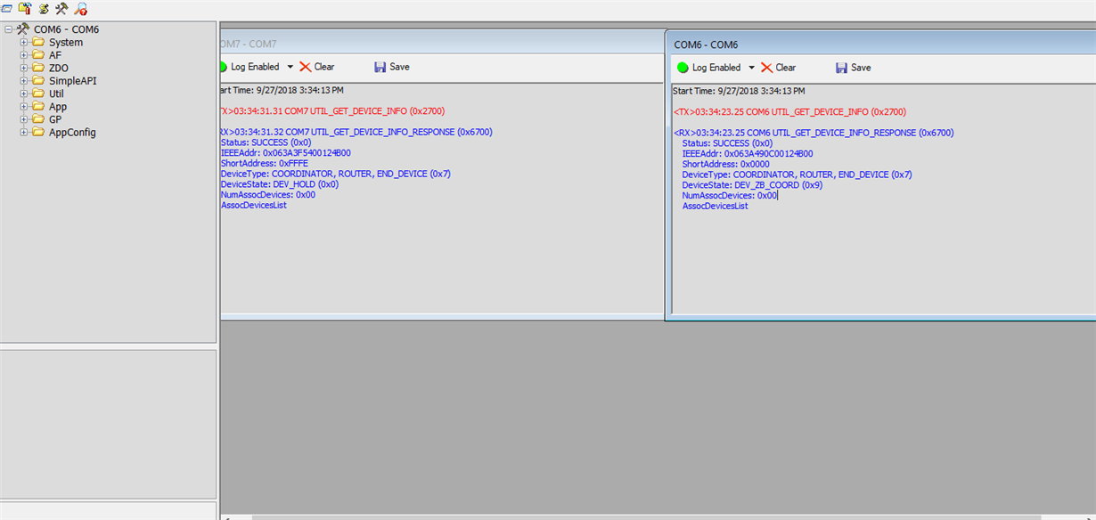

    <TX>11:22:59.42 COM7 UTIL_GET_DEVICE_INFO (0x2700)
    <RX>11:22:59.42 COM7 UTIL_GET_DEVICE_INFO_RESPONSE (0x6700)
    ShortAddress: 0xFFFE
    DeviceState: DEV_HOLD (0x0)
    AssocDevicesList
    But device didn't  changed from DeviceState: DEV_HOLD (0x0) to  DeviceState: DEV_END_DEVICE (0x6).
    Device still being in DeviceState: DEV_HOLD (0x0).
    Thanks in Advance,
    Amar.

    <TX>02:14:27.74 COM6 ZB_PERMIT_JOINING_REQUEST (0x2608)
    Destination: 0x0000
    Timeout: 0xB4
    <RX>02:14:27.74 COM6 ZB_PERMIT_JOINING_REQUEST_RSP (0x6608)
    <RX>02:14:27.75 COM6 ZDO_MGMT_PERMIT_JOIN_RSP (0x45B6)
    SrcAddr: 0x0000
    Status: ZDP_SUCCESS (0x0)

    In my scenario the another one device(End device) still being in hold state. I have shared below log files belongs to end device side.
    <TX>02:17:02.5 COM7 UTIL_GET_DEVICE_INFO (0x2700)
    <RX>02:17:02.5 COM7 UTIL_GET_DEVICE_INFO_RESPONSE (0x6700)
    AssocDevicesList
    When the hold state device will turn into end device.

    Here when i send UTIL_GET_DEV_INFO  from end device side. Got response below shown.
    <TX>05:53:10.19 COM15 UTIL_GET_DEVICE_INFO (0x2700)
    <RX>05:53:10.2 COM15 UTIL_GET_DEVICE_INFO_RESPONSE (0x6700)
    IEEEAddr: 0x00124B0006272A09
    DeviceState: DEV_NWK_DISC (0x2)
    AssocDevicesList
    At end device side continuously showing.
    <RX>05:53:11.02 COM15 ZDO_STATE_CHANGE_IND (0x45C0)
    State: INVALID_PARAMETER (0x2)
    <RX>05:53:11.77 COM15 ZDO_STATE_CHANGE_IND (0x45C0)
     Thanks and Regards,
    Amar.
